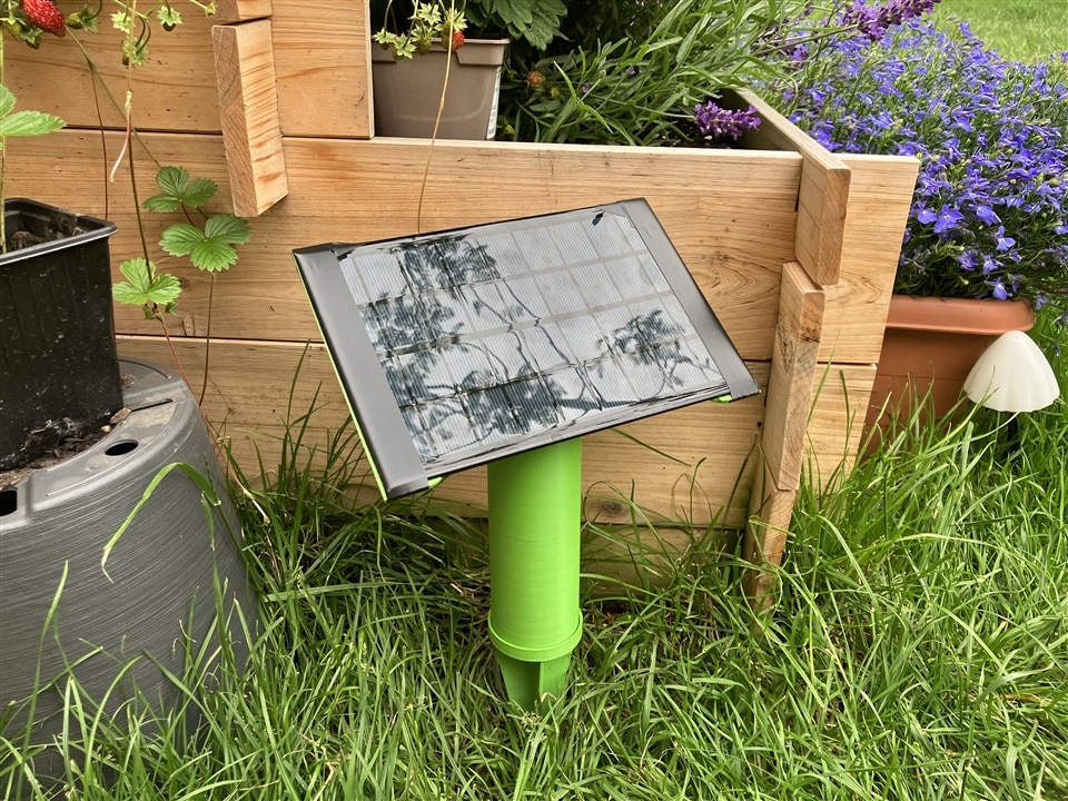

In this, the final post for this project, I would like to firstly share with you the web domain for https://pollinatorpollster.cloud/, this is the website hosted on the Raspberry Pi 4 on which you can see the data collected by the prototype sensor. This Pi 4 receives the detection data from the Pico-powered sensor, saves and graphs it, then posts those charts to the site it hosts. Please bear in mind if this is getting many visitors it may run a little slower, but I will do my best to ensure it stays 'up' during this time.

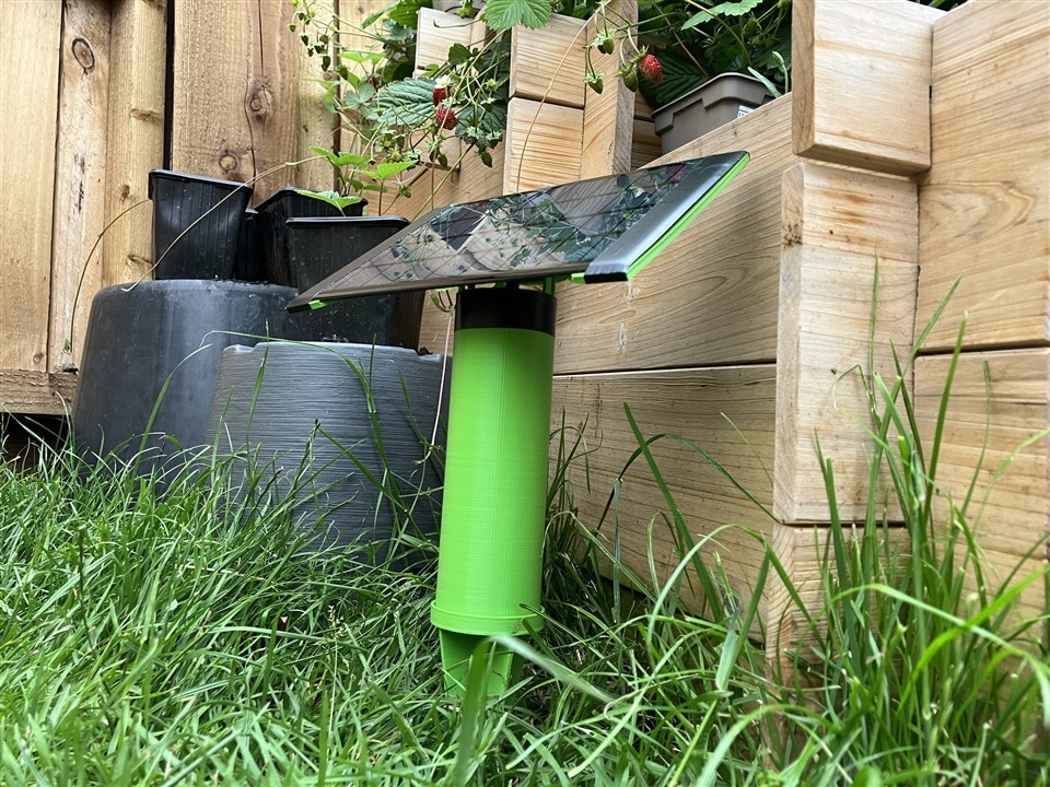

The prototype sensor is now set up in the garden, adjacent to lavender, strawberry, lobelia and daisy plants, all of which are in flower and see a lot of activity from bees and other insects so should be plenty to detect!

Overall, I believe the prototype system has met the project goals, it couples a low-cost solar-powered sensor based around commonly available components within a 3D printed body, with a Raspberry Pi 4 which hosts a lightweight website that allows researchers to access the sensor data over the internet. The audio classification approach from initial tests appears reliable, as is the ability of the sensor to run continuously without power loss or loss of radio transmission between the sensor and hub. The usage of the HC-12 transceiver permits multiple sensors to be connected to the same hub whilst utilising the same frequency, as an identifier could be added to the transmitted messages to allow the hub to ascertain from which sensor data was received.
I am pleased that the system has come together in time for the contest deadline, but I am also aware that this is a first prototype with therefore some areas for improvement ~

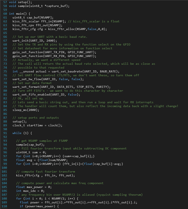

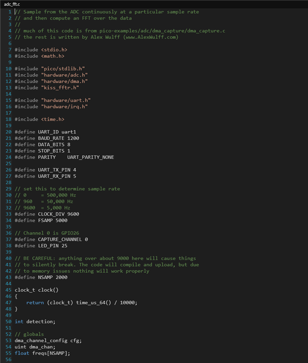

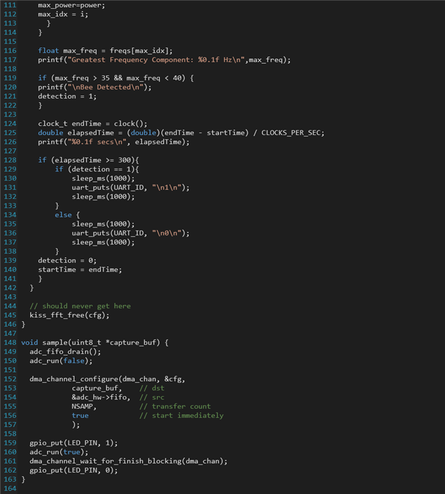

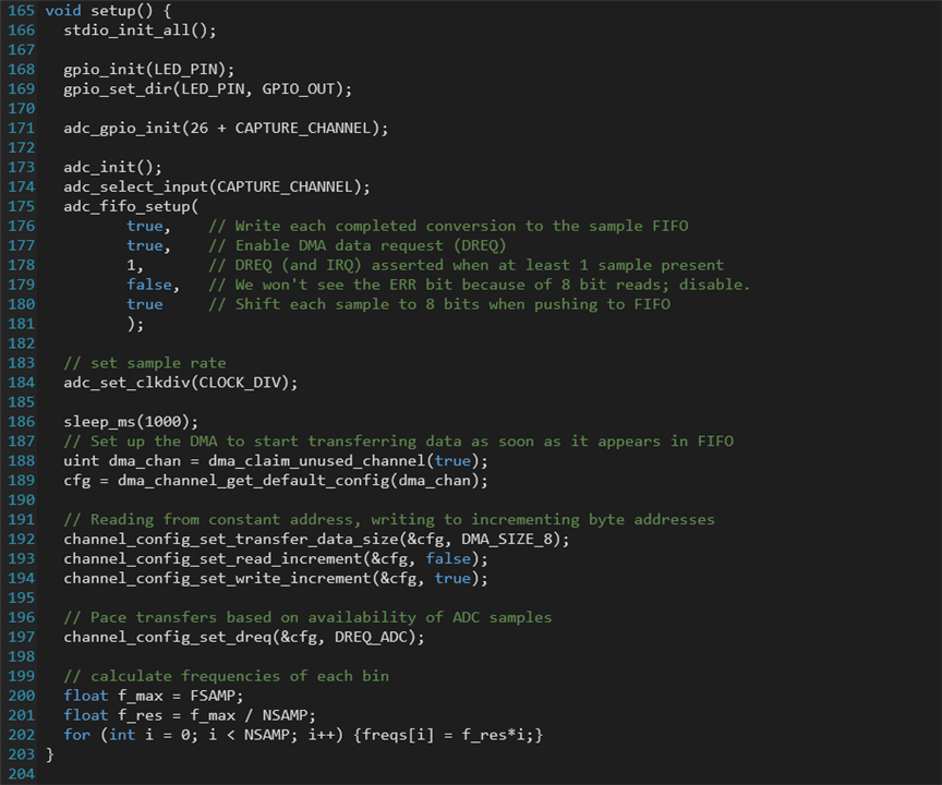

Appendix 1: The Code Running on the Pi Pico
The C++ code which runs on the Pi Pico is shown in full below. This is explained in more detail in Part 7 of this blog series. It is based around C++ Fast Fourier Transform developed for the Pi Pico by Alex Wulff. On top of this is added a detection test, if the max_freq variable is within the 35 to 40Hz range it signifies the detection of a Buff-Tailed Bumblebee, which in field tests was found to exhibit a maximum frequency component of 37.5Hz. Every 5 minutes it then triggers the writing of the detection [1/0] to the Serial, which sends it to the attached HC-12 transceiver and sends it.

Code Part 3: Includes detection algorithm and code to send data at 5 minute intervals.
Code Part 4: Setup function.

    Update 18/07/23: The sensor has been deployed for 3 weeks now, and it has been fun to see what data has been collected. Good weather over the weekend resulted in nearly 4 days of continuous operation and data collection, albeit with a brief pause when storms on Sunday actually blew it over, and the panel ended face-down in the grass, resulting in a drained battery by that afternoon. We are back to overcast weather now so it has not been in operation since yesterday afternoon. I am pleased that it has survived the weather conditions, as the thing has had a hard time with rain recently!
