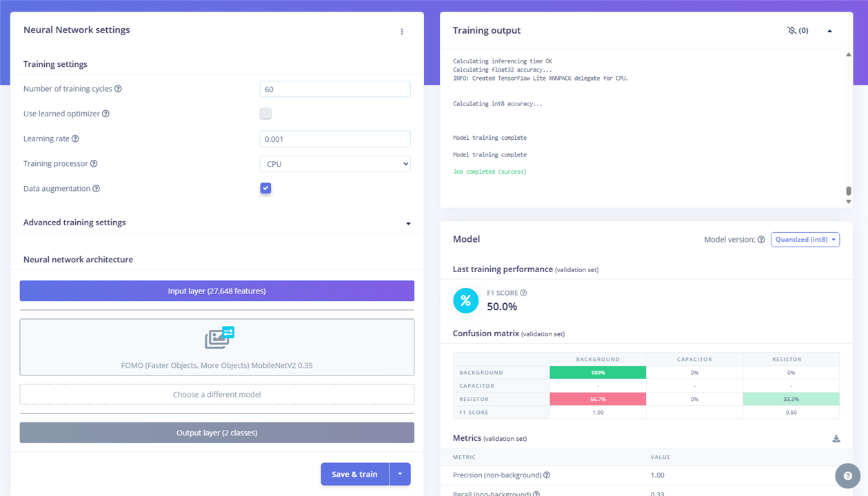

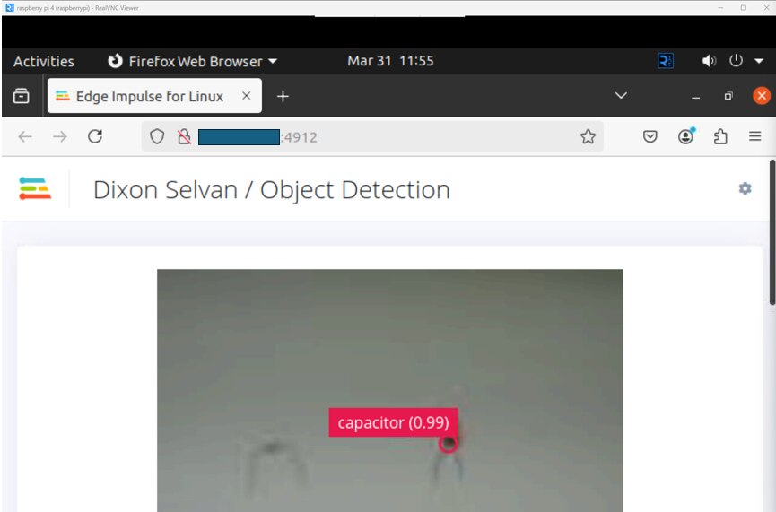

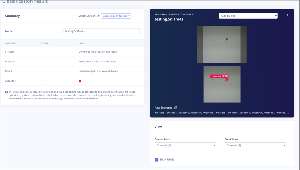

  4. Object Detection - I then trained the model (FOMO (Faster Objects, More Objects) MobileNetV2 0.35) using the default settings. Refer screenshot in gallery below which shows the training output and model summary.
  5. Live Classification - Then I did a quick live classification and could see the model was able to find the capacitor but not the resistor. Anyways, I'll be loading more dataset and training the model again. For starters, the flow is working as expected. Refer screenshot in gallery below which shows the live classification outcome.

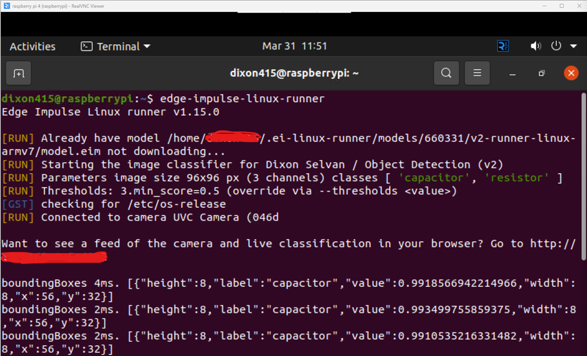

  6. Execution - Ran the below command in the terminal of Raspberry Pi and refer screenshot in gallery below which shows the outcome of the same.
edge-impulse-linux-runner

Execution - Raspberry Pi Terminal

Below image shows on the right Raspberry Pi showing preview of live classification and to the left is Arduino IDE Serial monitor showing the classified output received at Arduino's end.
Classification output passed to Arduino

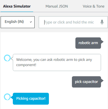

After this, I had deployed and tested it in the simulation tool available. Below screenshot shows the dialog flow.

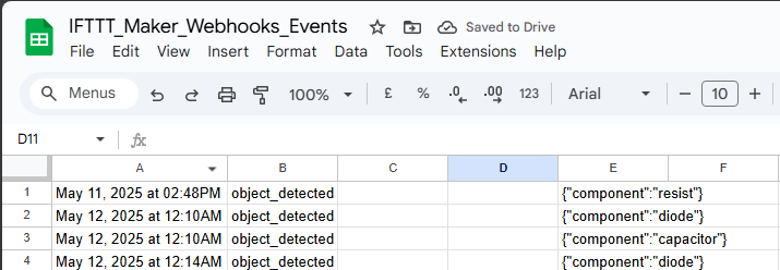

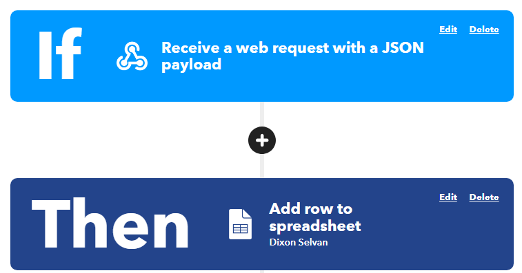

Now, let's move on to see the setup of IFTTT and Google Sheets. In IFTTT, I created a new applet with the setting shown below. Alexa will trigger a POST request to the IFTTT Webhook with JSON payload having the component name. This will be then added as a new row in the Google Sheets with some additional information like date created.
Below screenshot shows the information captured finally in the Google Sheet. Column A - date created, Column B - event name, Column C - JSON payload.

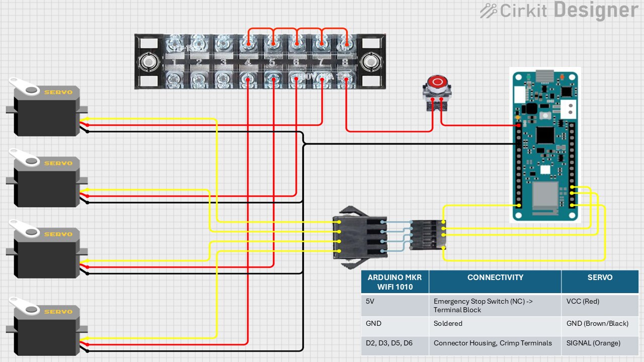

Below is the circuit diagram/ representation of the Robotic Arm (some might not be actual representations of the parts used and are a close match). I had initially used single core wires throughout the circuit, but it seems to disconnect very often making the responses of the robotic Arm unstable to the input provided. As a result, I have done the wiring again with multicore wires. Now, the robotic arm is stable and works as expected.
Wiring - Robotic Arm
I have used the TE Connectivity terminal block and Emergency stop switch in the 5V connection to the Servo from Arduino. All the red/ VCC wires from the servo motors are connected to the terminal blcok and one wire is connected to 5V of Arduino through the Emergency stop switch (NC). When I connect or plug in the Arduino, there are some signals passed to the robotic arm causing it to stumble at times. So, I have connected an emergency stop switch to stop this while turning it ON or powering up and later allow the circuit to behave as expected. Also, it can be used in case of emergency situations which gets out of hand.
All the ground wires are soldered together.
All the signal wires are connected to D2, D3, D5 and D6 pins of the Arduino through TE Connectivity crimp terminal (other brand also) inside TE Connectivity connector housing (male and female). This way we can easily connect and disconnect when required.

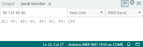

For quick testing purpose, I've written below code which uses serial connection to send the angles which I want each of the servos to rotate to. We can use it to test the servos individually as well by providing the last angle which was provided to the other servos. Be careful while giving the angles which might be obstructed by another servo as in the case of the two servos controlling the up, down, front, and back motion.
The input and output example can be seen below. I have used the Arduino IDE installed in my laptop and opened the serial monitor section for this.
