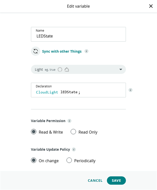

    1. In ‘Cloud Variables’ heading click on the ‘Add’ button and then enter values as shown in screenshot below and click on ‘Add Variable’ button.                                                                                                                                                                                                                                                 image

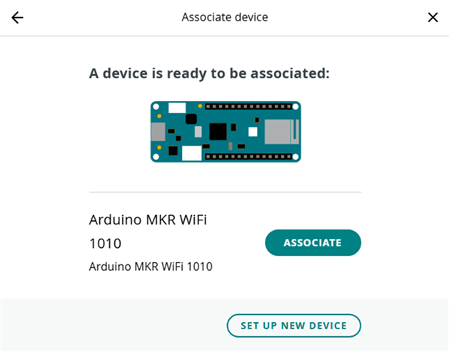

    2. Under ‘Associated Device’ heading click on the button above ‘Select Device’ text and associate Arduino MKR WiFi 1010 board. Click on ‘Set up new device’ button to create a new device and then associate it.                                                                                                                                                    image

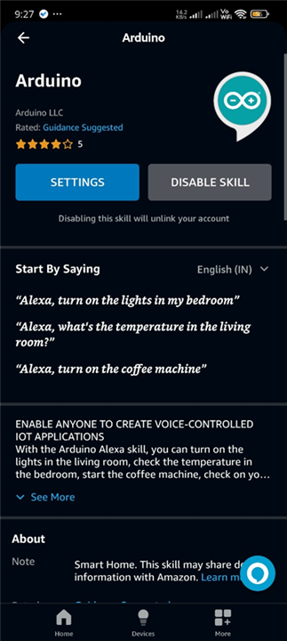

  2. To configure, I’ve installed Alexa app on my android phone. Go to ‘More’ tab and then click on ‘Skills & Games’ option. In the search bar, type Arduino and enter. Select the Arduino skill as shown in screenshot below and click on ‘Enable to Use’                                                                                                                                  image
  3. After a while, it would show like ‘1 Other light found and connected’.
  4. Click on ‘Next’ button and then ‘Skip’ followed by ‘Done’.

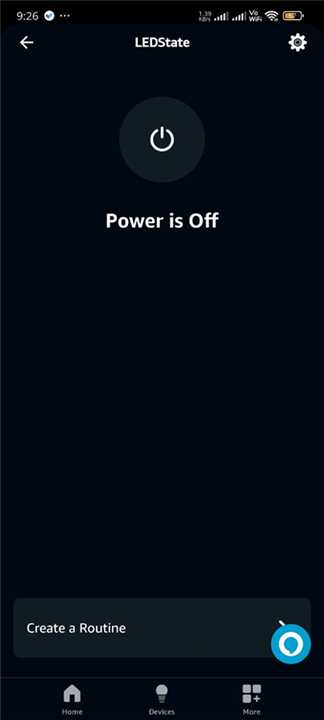

  5. Under ‘Devices’ both Echo Dot and ‘LEDState’ (Cloud variable created in previous section) would be visible.                                                                                                                                                                                                                                                                                                                                              image
  6. Click on ‘LEDState’ and then you would be presented with a page having power button. Turn it ON and OFF to see it in turn Turn ON and OFF default LED in Arduino MKR WiFi 1010 board.                                                                                                                                                                                                                        image

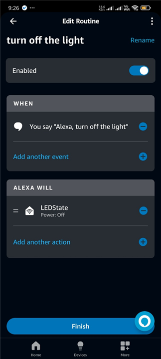

  7. In the bottom, click on ‘Create a Routine’. You can see by default two routines created ‘turn off/on the light’.
  8. Click on one of them and under ‘Alexa Will’, click ‘+’ button to add an action.
  9. Select ‘Smart home’ and then ‘Lights’ followed by ‘LEDState’.
  10. Click on ‘Next’ in top right corner and choose respective state ON/OFF and click on ‘Next’ followed by ‘Finish’.                                                                                                                                                                                                                                                                                                                                                image
  11. Repeat the same for the other routine.
  12. Now you can ask ‘Alexa, turn on/off the light’.
