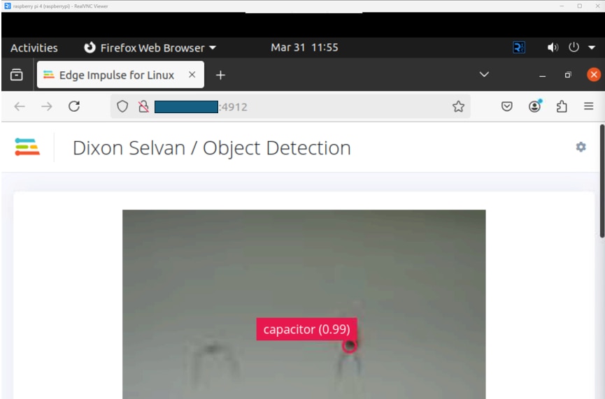

Edge Impulse - Testing Data Acquisition
I was able to successfully test Data Acquisition as well. Below is a screenshot of the same. I have also manually created a bounding box and labelled it as a resistor. Since I'll be using object detection to find items in my inventory.
Edge Impulse - Training, Testing, and Deploying the model
  1. Data Acquisition - I then sampled a few more pieces of data and made one sample as test data.
  2. Create Impulse - I then created below Impulse with the following steps - resizing the image to 96x96, an image preprocessing block, then added an object detection learning block, output it automatically selected the name of the items (resistor/ capacitor).
  3. Image - Then I generated features using the training data set.
  4. Object Detection - I then trained the model (FOMO (Faster Objects, More Objects) MobileNetV2 0.35) using the default settings. Below screenshot shows the training output and model summary.
  5. Live Classification - Then I did a quick live classification and could see the model was able to find the capacitor but not the resistor. Anyways, I'll be loading more dataset and training the model again. For starters, the flow is working as expected. Below screenshot shows the live classification outcome.
  6. Deployment - Ran the below command in the terminal of Raspberry Pi and below is the outcome of the same.
    edge-impulse-linux-runner
In case of any challenges, you can refer to this official documentation - https://docs.edgeimpulse.com/docs/edge-ai-hardware/cpu/raspberry-pi-4. Stay tuned for more!
