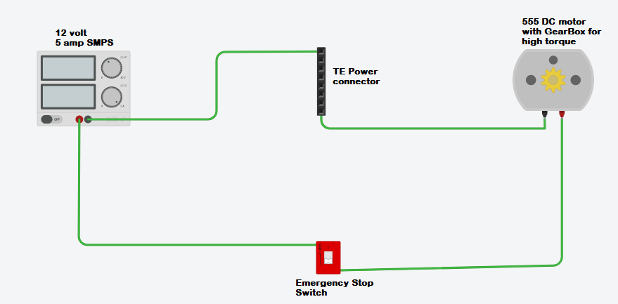

This heavy duty PCB cutter requires 12 volt supply and around 5 amp for it's DC motor to work. The DC motor has gearbox to increase it's torque. The DC motor is a 555 DC motor. Bellow is the schematic diagram for the electrical circuit with an emergency stop switch.
Schematic

Step 5:-
In this step we do the wiring as provided in the Schematic diagram above.
