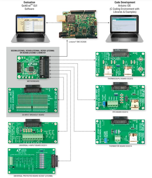

    rsc over 1 year ago +1
    Analog Devices has a temperature measurement development system with a board they call Linduino https://www.analog.com/media/en/technical-documentation/product-selector-card/2983d.pdf You may be able…

    rsc over 1 year ago
    You may be able to interface their thermocouple board to a MKR WiFi 1010
