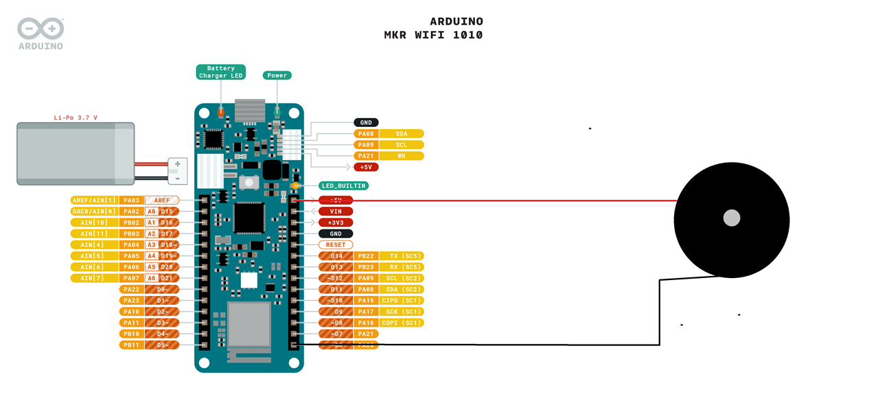

I have updated the buzzer to a larger buzzer with louder sound and it is an active buzzer. bellow is the video of the buzzer and sound of it.
For buzzer to work, we have connected the -ve terminal of the buzzer to IO PIN 6 and positive terminal of it to 5 volt of mkr wifi 1010 board. Bellow is the connection image of it.

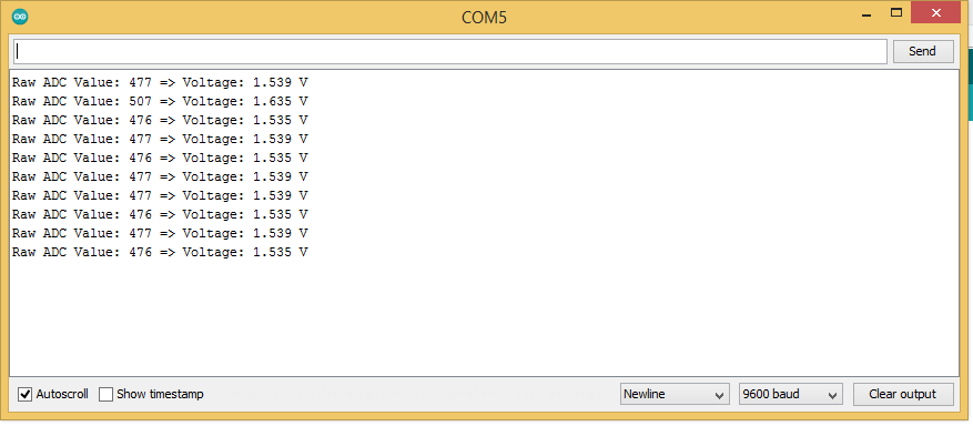

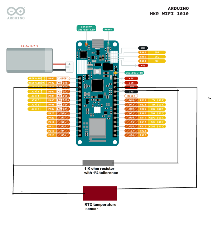

Setting up and testing RTD temperature sensor.
For setting up RTD we have build a voltage divider with RTD using 1% tolerance resistor of 1 K ohm. Bellow is the circuit diagram of connecting the RTD.
Bellow is the code for testing the temperature sensor.

Output of the temperature sensor in serial monitor of arduino.
