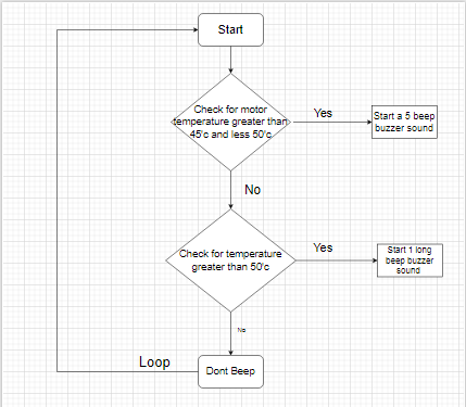

Flowchart for detecting motor temperature and giving sound indiction.
In the above flowchart you can see how the system software works. First it checks for motor temperature and gives proper indication about it. Bellow is the working video of the system.

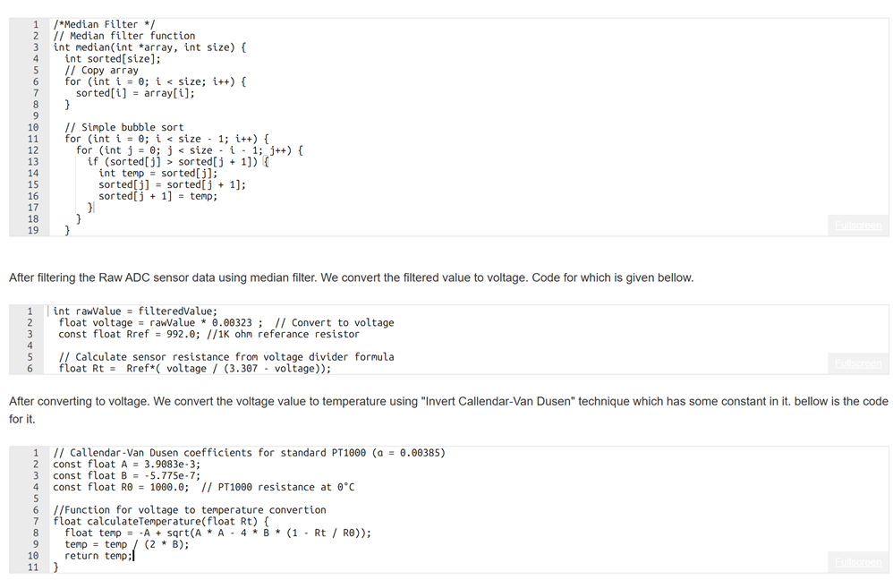

Arduino code
First we read sensor value from ADC.
 // Read sensor value
         int newValue = analogRead(A1);
Than we filter those value using median filter. Median Filter function code is given bellow. There were many software filter available like SMA(Simple mean average), LMA(Logarithmic mean average), median filter. SMA was still giving lots of error, so we have used median filter for processing sensor data. it was still giving some error. We are looking for more better software filter for processing sensor values.

After filtering the Raw ADC sensor data using median filter. We convert the filtered value to voltage. Code for which is given bellow.
 int rawValue = filteredValue;
  float voltage = rawValue * 0.00323 ;  // Convert to voltage
  const float Rref = 992.0; //1K ohm referance resistor
  // Calculate sensor resistance from voltage divider formula
  float Rt =  Rref*( voltage / (3.307 - voltage));
After converting to voltage. We convert the voltage value to temperature using "Invert Callendar-Van Dusen" technique which has some constant in it. bellow is the code for it.

    Jan Cumps over 1 year ago in reply to manojroy123 +2
    Your code does not do that: if(Rt > 1174 and Rt < 1194){ // ... 48, 49 } else if(Rt > 1194){ // 51, 52... } 50° is unsafe according to your comment above (it's above 45°, but not above 50°). But…
    Jan Cumps over 1 year ago +1
    delay(100); // wait for a second This will not do what you expect. See the delay() documentation: Description Pauses the program for the amount of time (in milliseconds) specified as parameter…

    I have told you, in another thread, that you can't decide on a better filter without looking at the noise signals you want to get rid of and comparing them with the signal you want to keep. From what…
