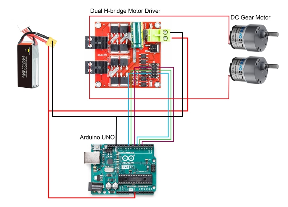

The motor, motor driver and Arduino connections are as follows:
For powering the motors a 3-cell Li-po battery is used. Below is the Arduino code for driving the motor in forward and backward direction.

A demo video:
