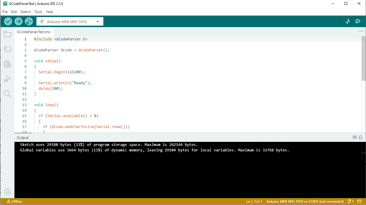

3 Implement G-code in arduino
3.1 Install Library Files:
In the Arduino IDE, install the necessary libraries.  To control the motor movement, libraries for controlling stepper motors or DC motors, like the Stepper library or AccelStepper library can be options.
3.2 Parse G-code Instructions
Write code to parse the received G-code instructions. You can create a function to extract information such as the movement mode (G00, G01, etc.), coordinate values (X, Y, Z), and feed rate (F) from the G-code instructions according to their format (e.g., G01 X## Y## Z## F##). Use string processing functions such as indexOf and substring to parse the G-code instruction string.
  1. Control Movement: Control the device movement based on the parsed G-code instructions. For the G00 rapid positioning instruction, use the fast - moving function in the motor control library to move the motor to the specified coordinates at a high speed. For the G01 linear interpolation instruction, control the pulse frequency and number of steps of the motor according to the set feed rate to achieve linear motion. At the same time, consider the control of acceleration and deceleration during the movement process to avoid motor stalling.
  2. Communication Implementation: Establish a communication connection with the host computer (such as a computer) via WiFi. Use the WiFi.begin() function to connect to the specified WiFi network, and then use the WiFiClient class to establish a TCP connection to receive G-code instructions sent by the host computer. You can create a loop to continuously monitor whether new instructions arrive, and process and control the device movement in a timely manner. Serial communication is used as bacis communication.
  3. Error Handling: Add an error - handling mechanism. When parsing G-code instructions, if an unrecognizable instruction or format error is encountered, send an error message to the host computer and stop the device movement to prevent abnormal actions of the device. At the same time, during the device movement process, monitor the state of the motor, such as whether stalling occurs, and handle it in a timely manner if an abnormality occurs.
Install G-code parser library and test the following example code
The selected motors shall be controlled with arduino in G-code parser for precise control for this shift-it challenger.
This is not one CNC machine, but some sort of machine arm control. Use g-code as start.
