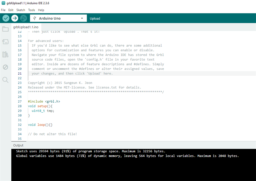

2 Incompatible platorm  for open-grbl
Here is the file structure for GRBL, this is for newest release of 1.1, previous version shows a little difference.

While this is for AVR core
and incompatible with SAMD core of MKR,

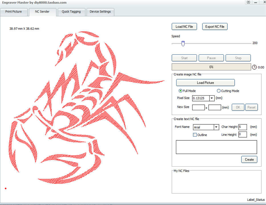

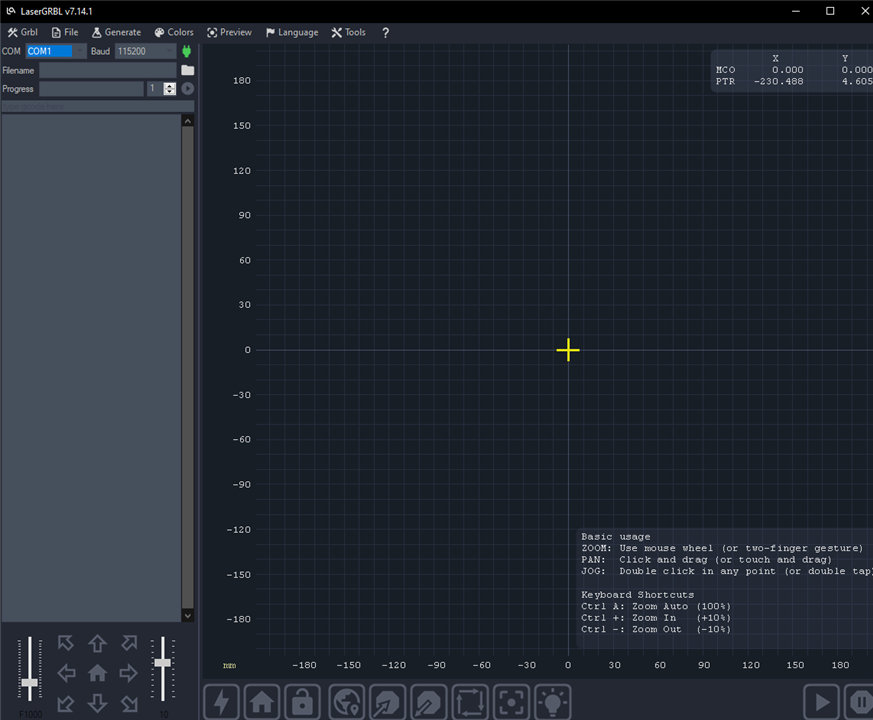

3 There are good software for g-code sender
One of the popular is laser-grbl
Here is another one engrave master.
It is good start to use one arduino UNO with hex download. This project needs MKR wifi 1010. That would take a great deal time to understand G-code and micro-core for this coding.

    That is good point. Even in 1000 lines in gcode.c, only basic function is supported. Just enough for laser engravers. The lasergrbl in github is good enough for most cases and update regularly.
