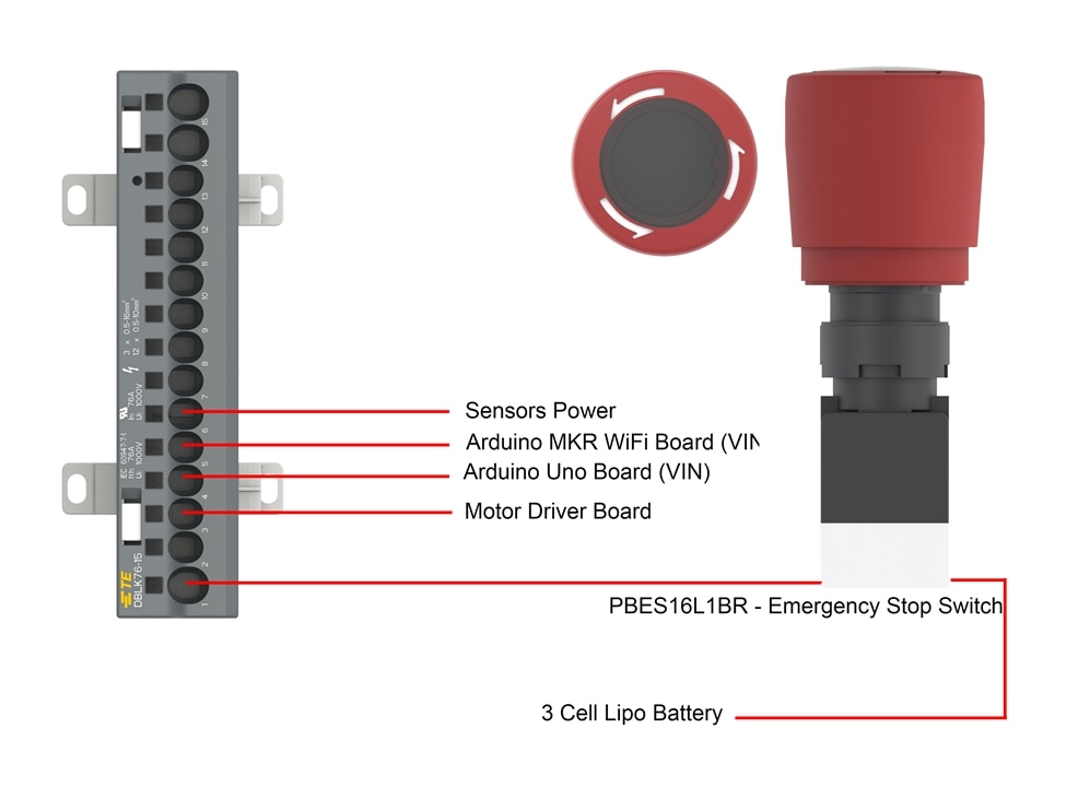

Distributing power to a complex project is not a easy task where lots of power connections is required. In my project I need to distribute 12V supply from the battery to different parts like motor driver board, microcontroller unit and the sensor unit. A power distribution block can be a good choice for this purpose. Here I am using the TE DBLK POWER DISTRIBUTION BLOCKS based on PI-Spring (Push-In & Spring) technology, specially designed for power distribution  in control panel. No screw is required for this block and helps to save connection time.
The sponsor TE for this challenge provided DBLK76-15 power distribution block which is a high power 15 port distribution block, highly overrated for my project.

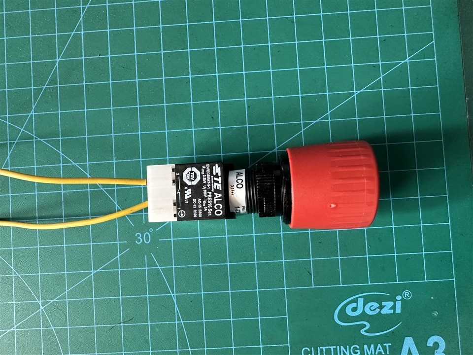

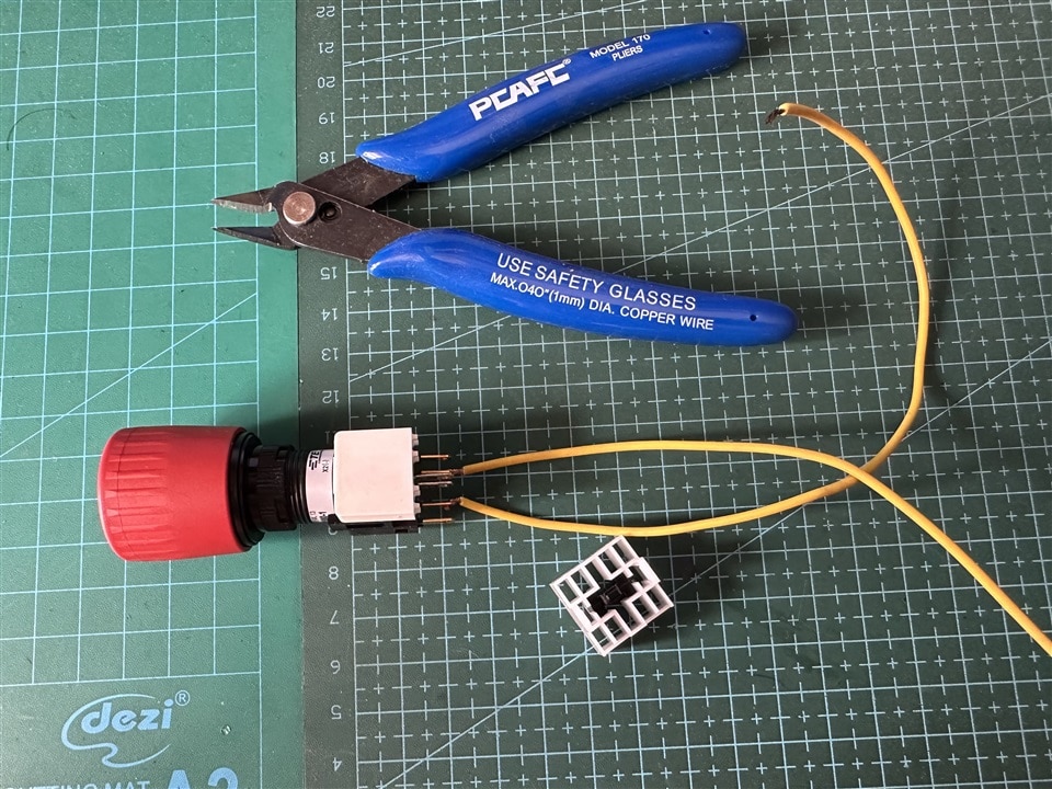

Above connection diagram shows the power connections among different components with the TE emergency switch. The following images show the connection of TE Emergency Stop switch.
