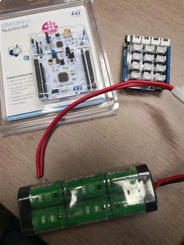

wow, time flies, i realize i haven't posted anything for 1 months plus. This post is a relatively short post
i was out for oversea trip for 2 weeks, also another 1 week for Chinese New Year holidays, nonetheless over the last one month, i have look at trying to build my motor driver circuit with MOSFET
i got some IPT60R028G7 infineon COOLMOS high current MOSFET, which is capable of 75A continuous drain current and an optocoupler TLP521-4
i then research on some home DIY PCB making methods that i haven't tried - using Vinegear and hydrogen peroxide like in https://electronics.stackexchange.com/questions/185824/hydrogen-peroxide-for-pcb-etching
seriously it seems i haven't design a proper PCB for quite some time, but is hesistant to use ferric chloride

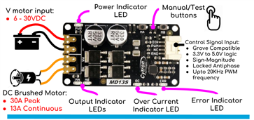

However, later on i discover a 13A capable driver board so i eventually just got myself 2 driver boards (since i have 2 motors)
It has grove compatible control interface hence i am adding a grove shield to my setup. Now, i haven't crosschecked if the STM32F411RET6 will be
compatible with a grove shield. If it is not, i can always do a dumb action, let the MCU talk to an arduino uno with grove shield
So i have decided to still do without PCB first
here are the motor drive test line up
Next step
-test the 13A module today and write an update post tomorrow
Next next step
- come out with system model with Altair Embeb that can be simulated
