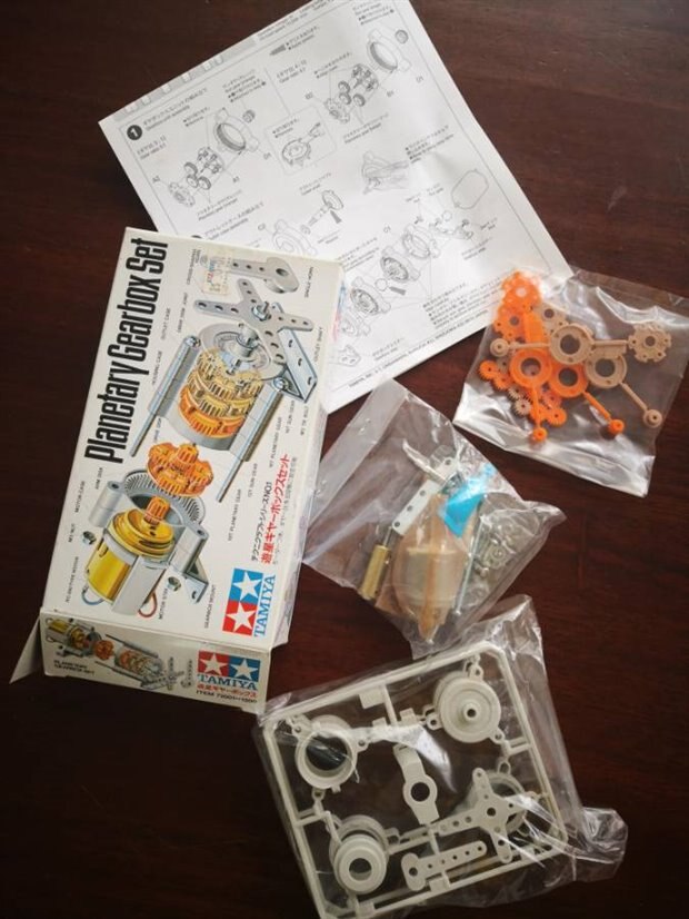

time flies, and soon it is deadline for contest.
today i am assembling the 'weapon' of the robot, the motorized scissor. First, i want to choose a suitable motor to drive the scissor
i dig from my collection and found this Tamiya motor set, and assemble it with 4:1 ratio
Then we do a simple test with power supply, driving both motor at 3V (low enough so that i can directly drive it from the Nucleo 64 later
http://vt.tiktok.com/JF5WPP/  << the link of the motor testing
i find that the Tamiya motor draw 1A, and runs much faster than the motor i salvage from a 4WD chasis.
I decide to use the smaller motor, that only draws 0.1A and runs much smaller but suitable for scissor speed.

    i find that the Tamiya actually can be stacked all the way up to provide 400:1 ratio, but it becomes too long for my bot, so i ended up still using the 4WD chasis motor
    note:
    ratios below are possible
    4:1, 5:1, 16:1, 20:1, 25:1, 80:1, 100:1, 400:1
