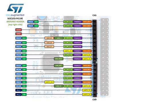

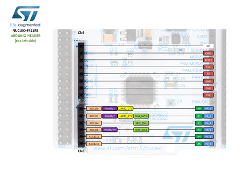

The Nucleo-F411RE has arduino compatible pinout. However, to use some of library created orginally for Arduino, we need to do some conversion from the arduino code to MBED.
When naming the pin, it is best to use the pin name under "MCU pin without conflict", those in blue colour. However, arduino pin name, LEDs and Buttons, MCU pins connected to other components
are also usable

i use the Arduino connector name for the motor function

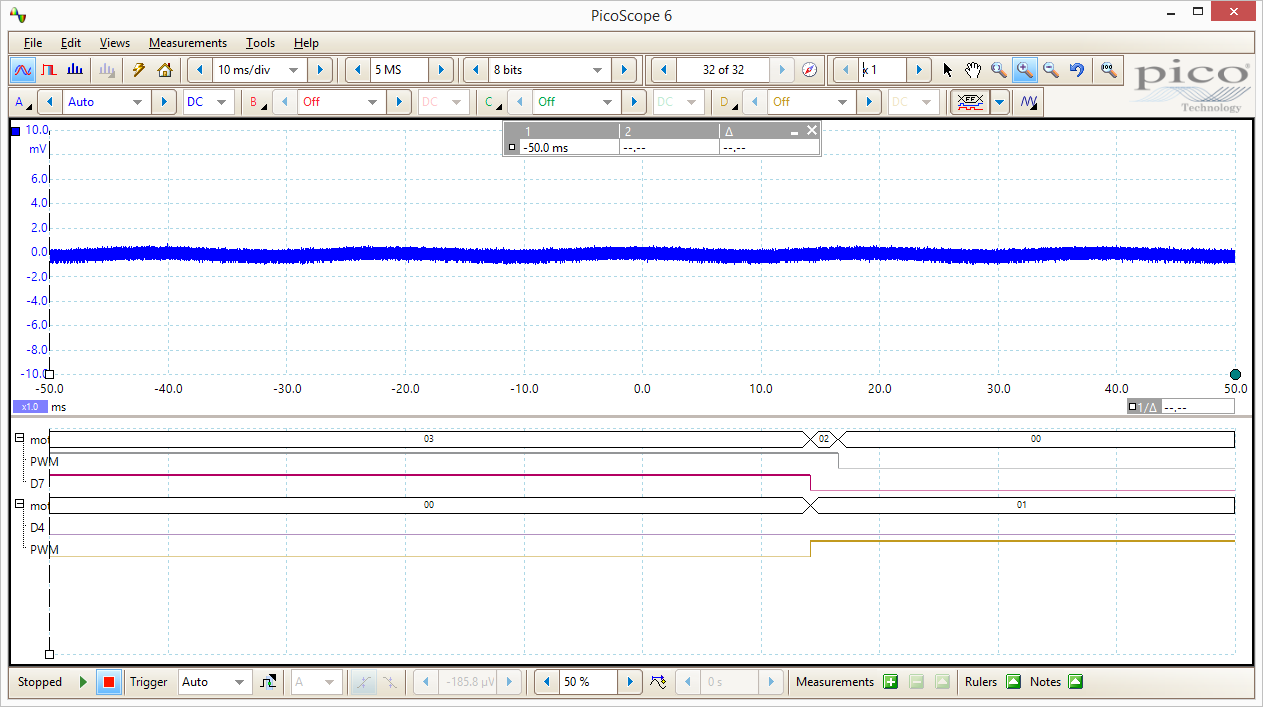

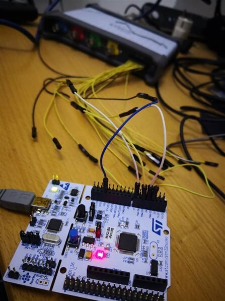

I use PicoScope 5444D MSO to capture the PWM and direction control pin for both my left motor and right motor. The video shows the LED is blinking, indicating it is alive
An always on powerbank is used to power the Nucleo-F411RE. It is also the final battery to be used for the MCU and sensor
Here is a the PWM and direction capture for left and right motor (look at the digital capture. The analog channel is not used). i create 2 groups, one for right motor, another for left motor
