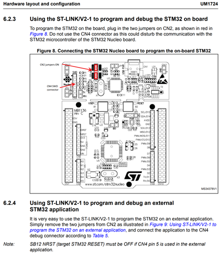

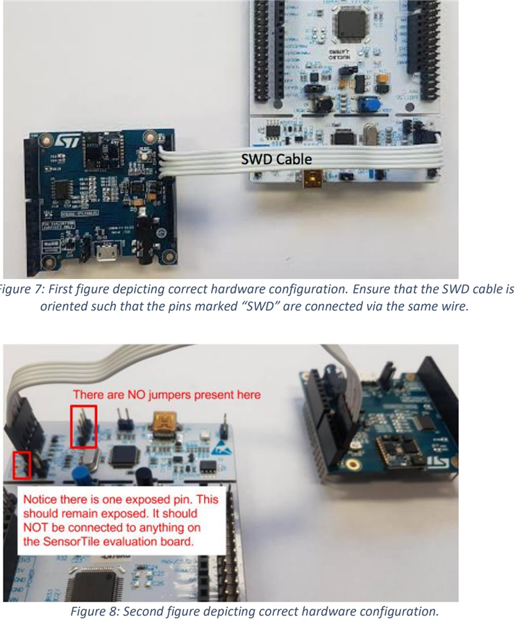

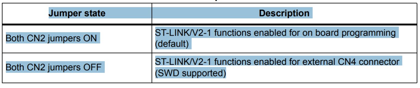

What's important is do the proper wiring as indicated in https://drive.google.com/file/d/1tjZSjwKYYoZ9eZGaUF-SJqWffQehxrOn/view
(this is file from tutorial 1 on UCLA - STMicroelectronics - STMicro ). It is important to note the pin marked "SWD" are connected via the same wire.
Now, why do we need to do so? The reason is on page 16 and 18 of [4] https://www.st.com/content/ccc/resource/technical/document/user_manual/98/2e/fa/4b/e0/82/43/b7/DM00105823.pdf/files/DM00…

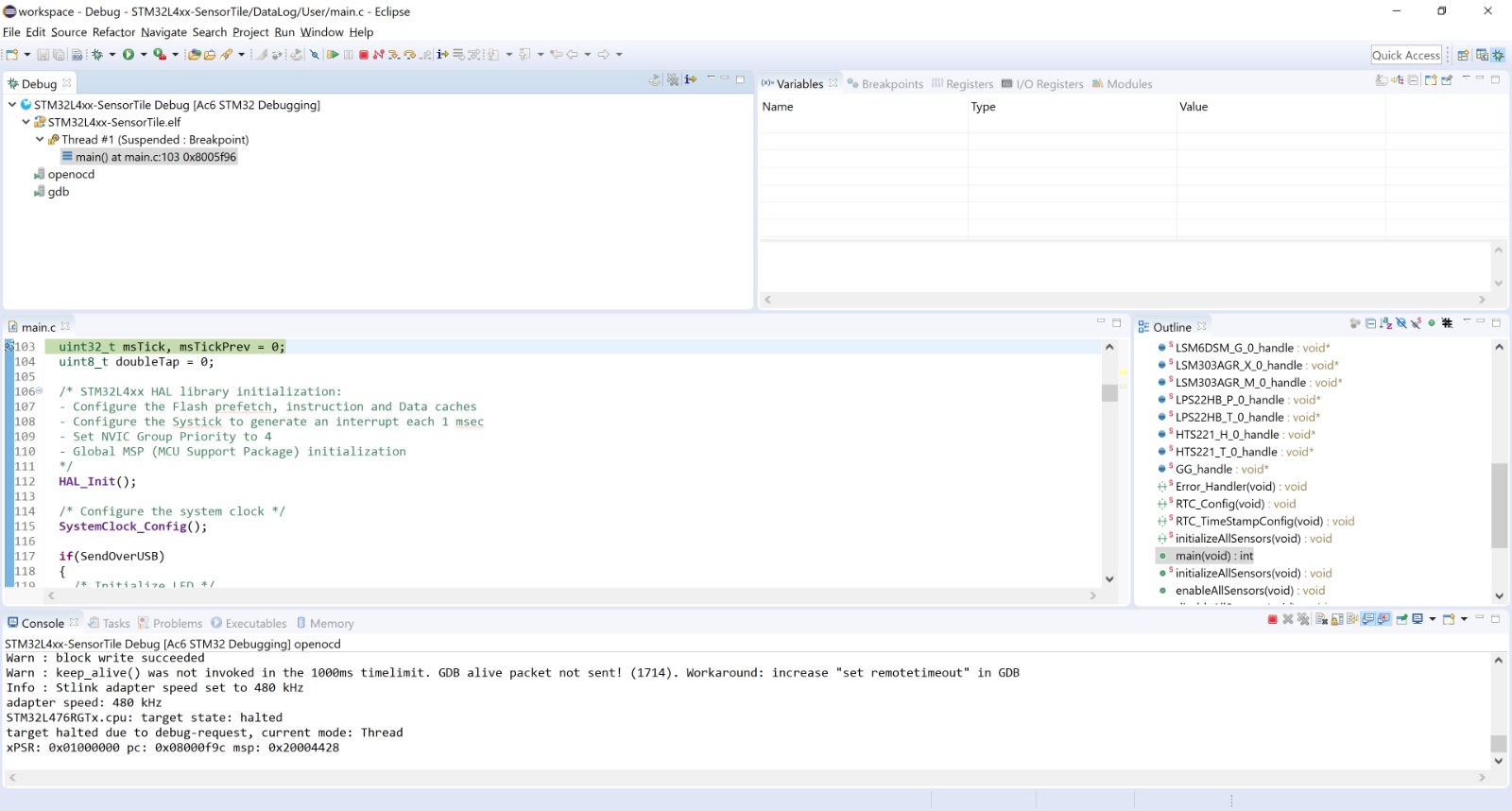

We then reach page 29 of the tutorial
click resume (F8) and the LEDs are blinking on the sensortile

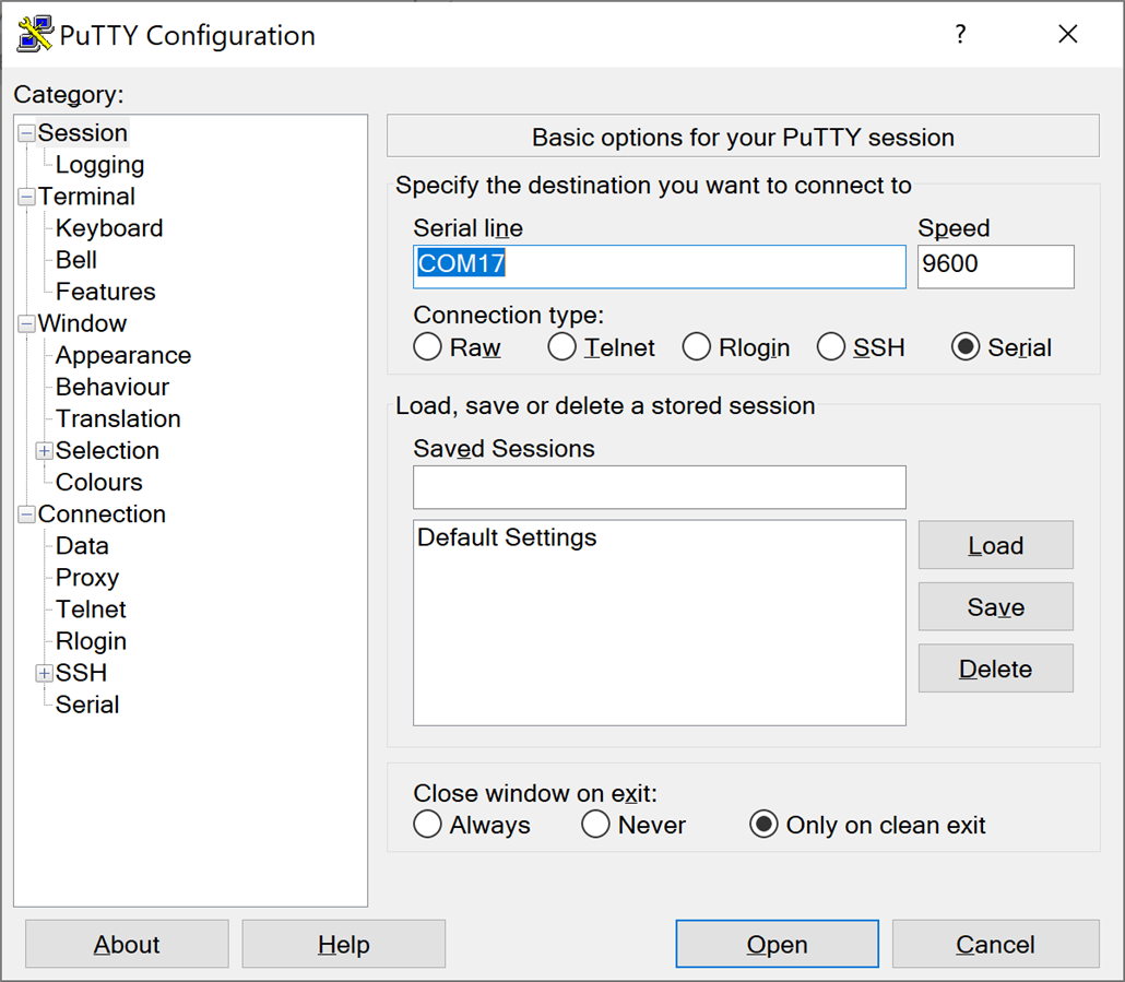

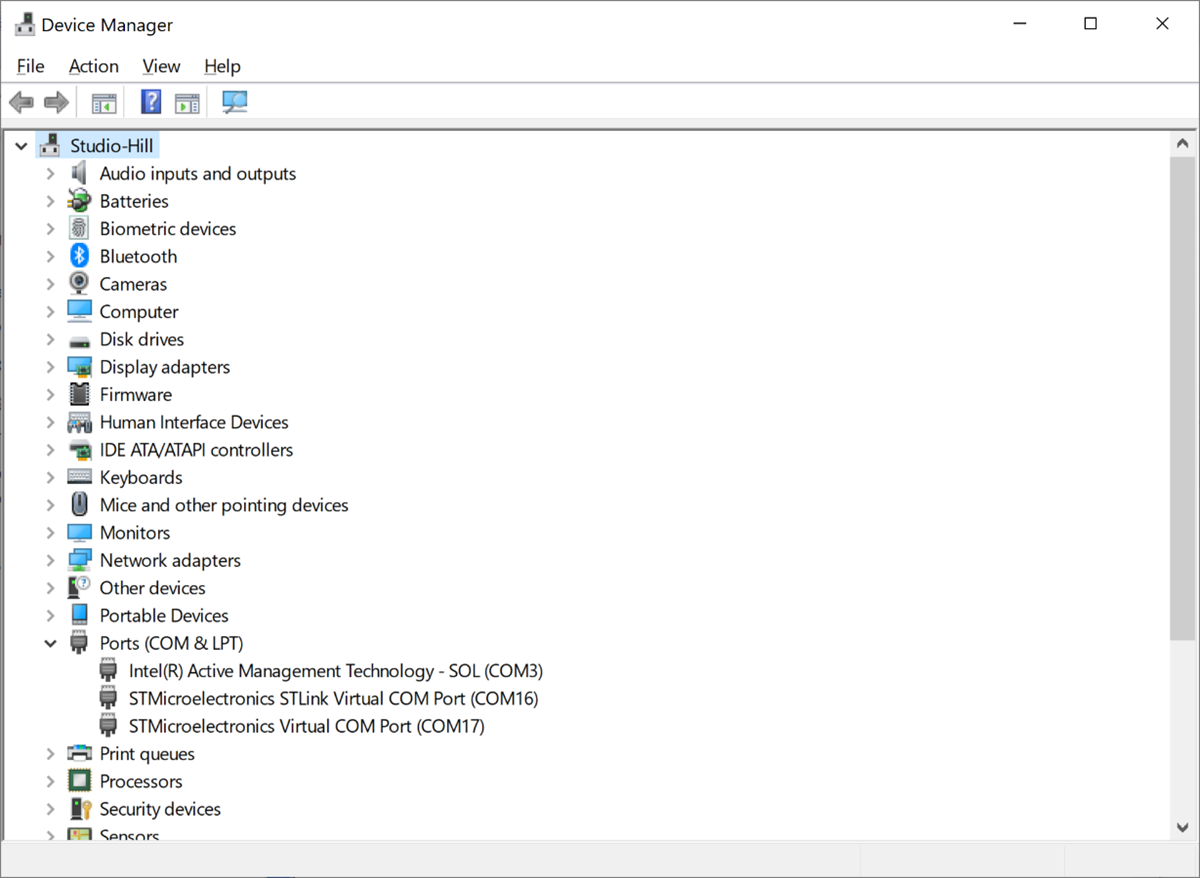

on my laptop, the nucleo is detected as COM16 and the SensorTile as COM17
Note: they only gets detected after we click resume in the debug

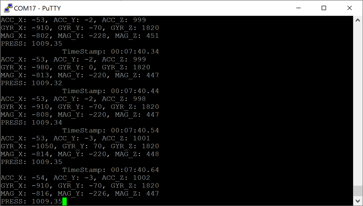

my SensorTile is correctly functioning, after connecting it via PuTTY
click open and we will see

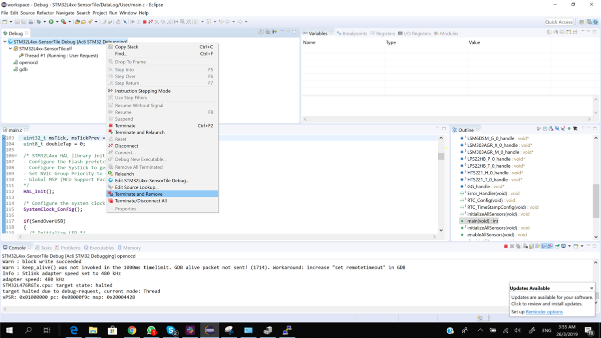

hence we will flash our program onto SensorTile every time the SensorTile is powered. The SensorTiles needs not be connected to Nucleo nor System Workbench.
We terminate and remove, like screen below

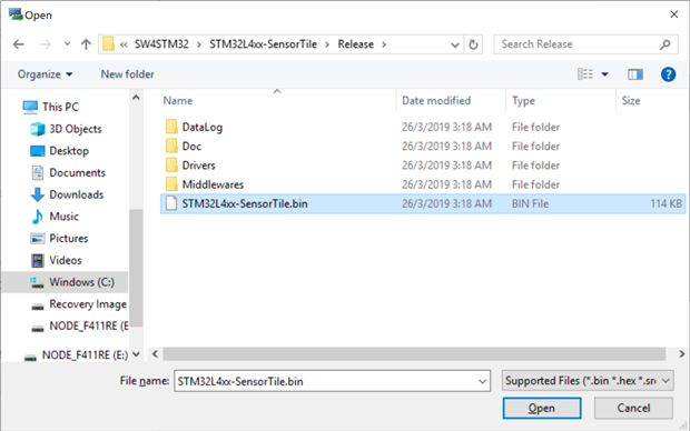

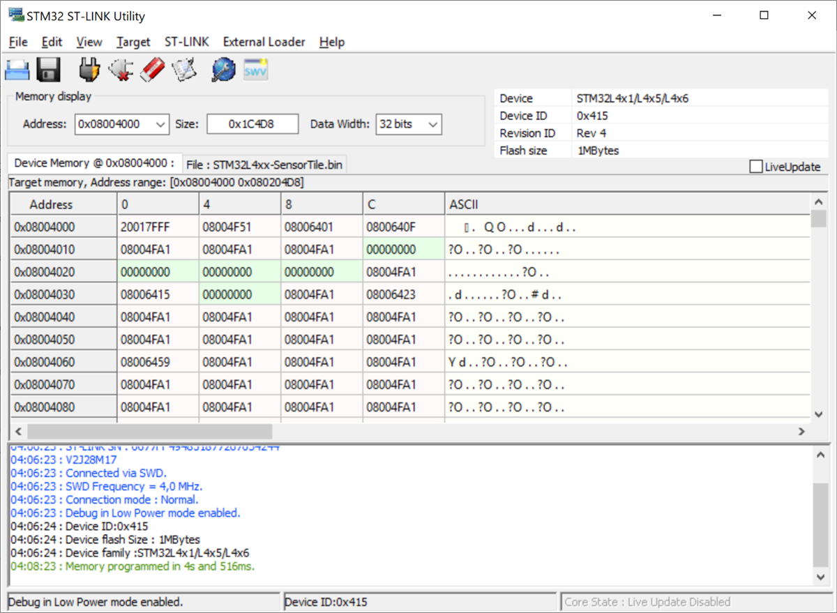

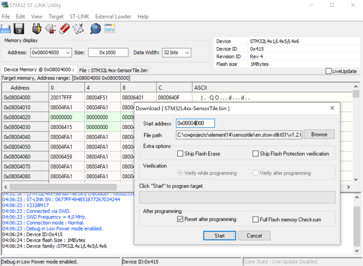

we then use the ST-Link Utility.
for mine it is at C:\Program Files (x86)\STMicroelectronics\STM32 ST-LINK Utility\ST-LINK Utility
follow page 34 of the tutorial
at the change address to 0x08004000, one cannot press enter else will address out of range error
click start from below screen
and we get this screen

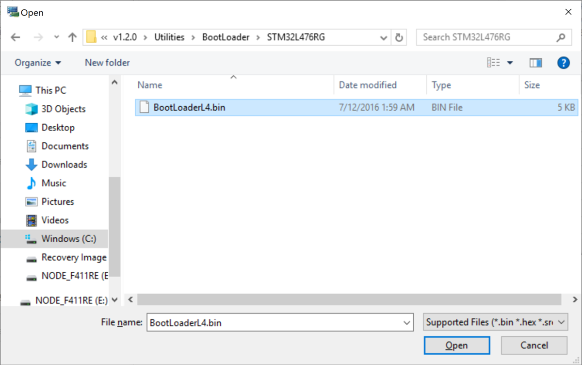

We close the file and browse to the bootloader file created here as screen below
follow page 38 of the tutorial, now with the address change back to 0x08000000 (don't know why ...)
by following page 39 (disconnecting the cable SWD connecting Nucleo and SensorTile), and reconnecting SensorTile only, then we can see that it can run standalone

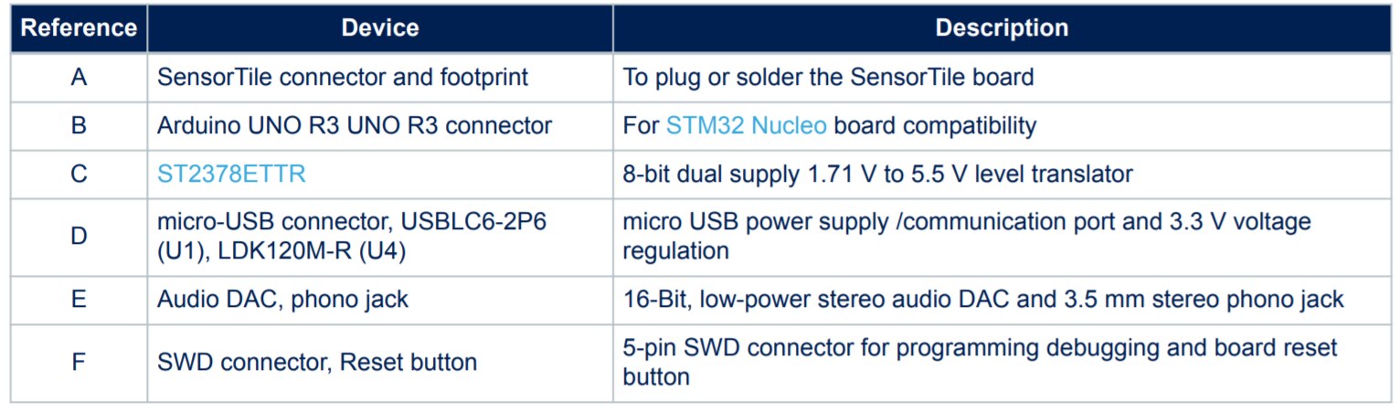

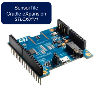

Now looking back at the STLCX01V1 cradle expansion board we have (the shield that the SensorTile sits onto), it has
-SensorTile cradle expansion board with SensorTile plug connector --> where we put our SensorTile onto
-compatible with our Nucleo-F411RE board through Arduino UNO R3 connector
-ST2378ETTR - 8 bit dual supply 1.71V to 5.5V level translator
-16 bit stereo audio DAC
-LDK120M-R 200mA LDO

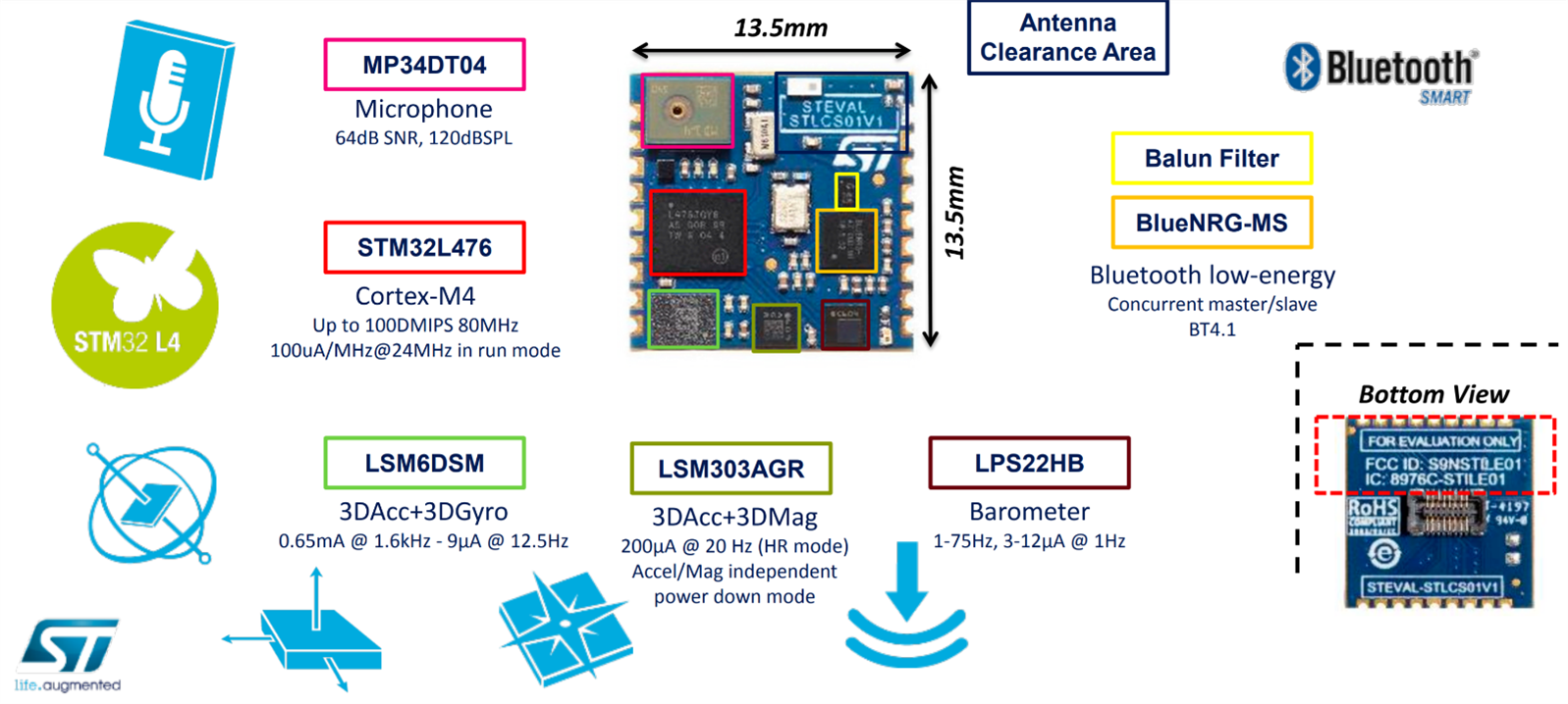

surprisingly i have some hard time locating its schematic. i eventually find it at page 9 of [5].

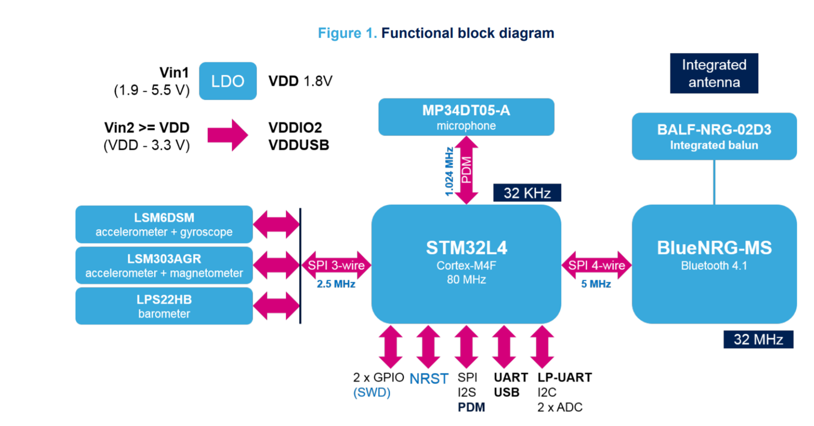

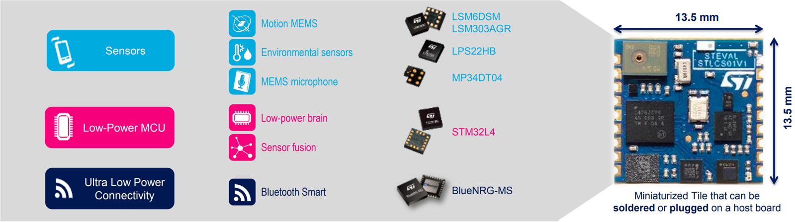

STEVAL-STLCS01V1 (SensorTile) is a highly integrated reference design that can be plugged into form-factor prototypes, adding sensing and connectivity capabilities to new designs through a smart hub solution
Main components:
  • STM32L476JG – 32-bit ultra-low-power MCU with CortexRegisteredM4F
  • LSM6DSM – iNEMO inertial module: 3D accelerometer and 3D gyroscope
  • LSM303AGR – Ultra-compact high-performance eCompass module: ultra-low power 3D accelerometer and 3D magnetometer
  • LPS22HB – MEMS nano pressure sensor: 260-1260 hPa absolute digital output barometer
  • MP34DT05-A – 64 dB SNR digital MEMS microphone
  • BlueNRG-MS – Bluetooth low energy network processor
  • BALF-NRG-02D3 – 50 Ω balun with integrated harmonics filter
  • LD39115J18R – 150 mA low quiescent current low noise LDO 1.8 V
