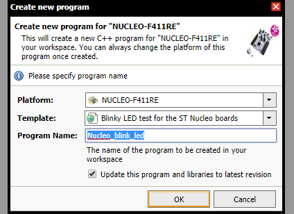

Today, i try with the MBED. It is cloud based and free. After logging in to your developer console, one need to select the supported board. I add the STM32F411 and choose to create a new hello world example....in this case the LED blinking.
Screenshots below show the steps involved.

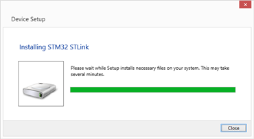

The STM32411 board is connected to PC with mini USB connector cable. On my windows 8.1 machine it will auto install the driver but fail. The STM32 STLink is a on board in-circuit debugger
To install the driver successfully, go to https://www.st.com/en/evaluation-tools/nucleo-f411re.html , download and install the STSW-LINK009

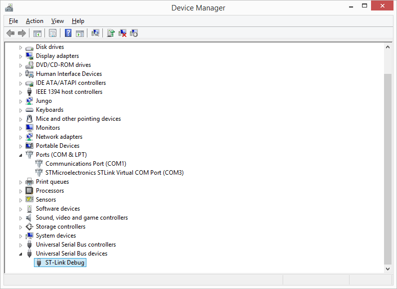

With successful installation, you will see the STLink virtual com port as well as the ST-Link Debug

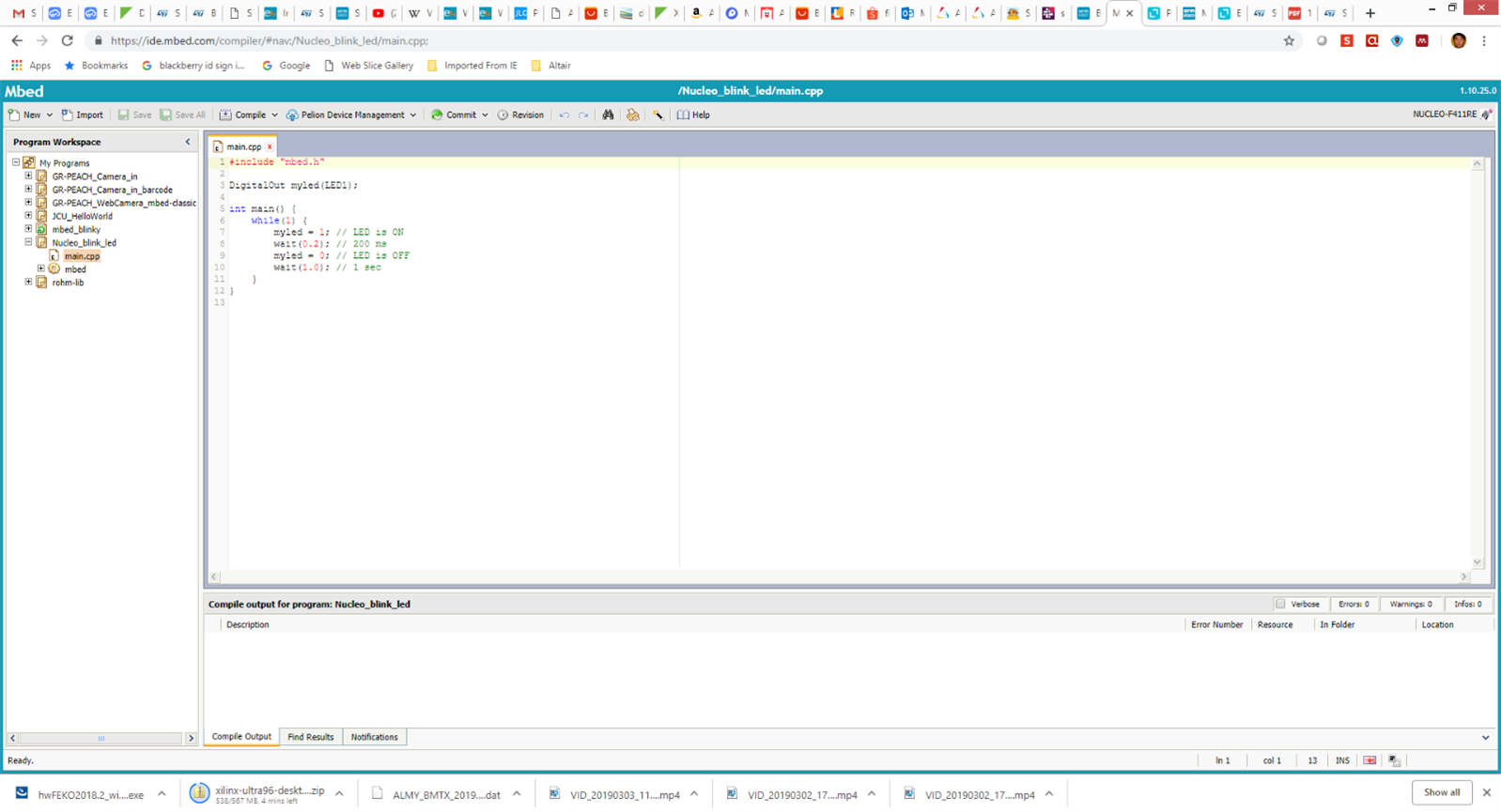

Going back to the mbed, we press the compile button. for the LED blinking example a file Nucleo_blink_led.NUCLEO_F411RE.bin is created and downloaded. In windows explorer, we drag and drop this to STM32F411 drive
the board will then has its LED labelled with LD2 blinking with every 1s interval. To make sure that we are really successful with programming the board, change the interval to 5s by modifying the code to below.
drag the created bin file again and voila the LED should now blink with 5s interval
#include "mbed.h"
DigitalOut myled(LED1);
int main() {
    while(1) {
        myled = 1; // LED is ON
        wait(0.2); // 200 ms
        myled = 0; // LED is OFF
        wait(5.0); // 1 sec
