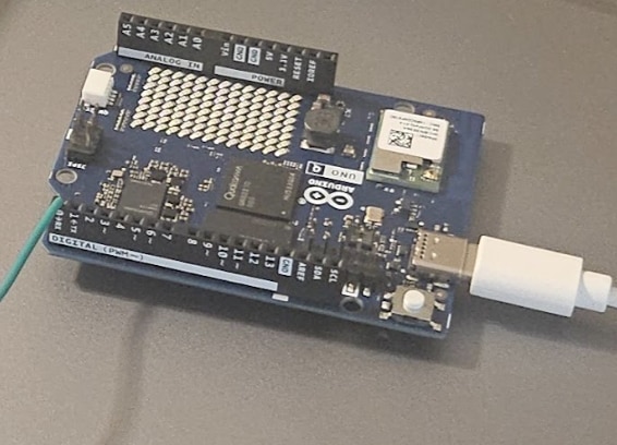

1.1 Central Hub Architecture (Arduino UNO Q)
  • Primary functions: Network orchestration, telemetry aggregation, and high-level logic management.
  • Dual-Processor System: MPU for Web UI and intensive data logging; MCU for deterministic low-level communication protocols.
  • Database BRICK Integration: Ensuring reliable storage of all streamed telemetry data.

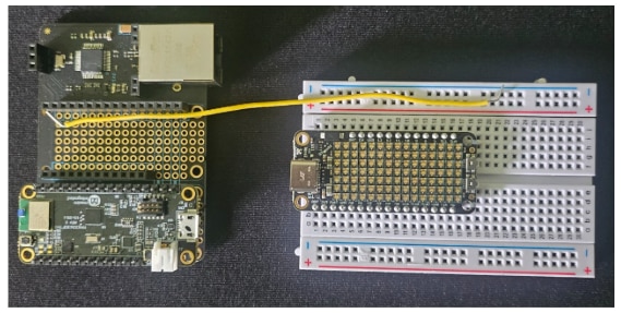

1.2 Edge Node Architecture (Modular FeatherWing Subsystems)
  • Deployment Strategy: Positioning modular edge nodes in designated building zones for localized data collection.
  • Connectivity Strategy: Initial rollout employing a stable UART infrastructure as a performance benchmark.

  • Central Hub Architecture: The Arduino UNO Q uses a Dual-Processor System, with the MPU for data logging, and the MCU for deterministic low-level communication protocols.
  • Edge Node Hardware: Deployment relies on modular FeatherWing Subsystems utilizing the MAX32630FTHR with specific logic integration.
  • Connectivity Baseline: Initial reliable data transfer is established using a UART infrastructure.

3.1 Central Hub Implementation
  • The Arduino UNO Q serves as the primary coordinator, utilizing its dual-processor architecture to ensure deterministic performance. The MCU handles low-level interrupt-driven UART communication from the edge nodes, while the MPU manages the Linux-based Web UI and Database BRICK integration for persistent storage.
  • The Central Hub implementation on the Arduino UNO Q leverages its dual-processor architecture to ensure deterministic, low-latency control on the Microcontroller Unit (MCU) side and robust high-level services on the Microprocessor Unit (MPU) side.

4. UART Interconnect
The physical layer of the Adaptive Sentinel utilizes a wired UART backbone to ensure high reliability and deterministic communication between the distributed Edge Nodes and the Central Hub. This infrastructure bypasses the potential latency and interference issues of wireless environments, providing a stable foundation for real-time security telemetry.
The connectivity is established via point-to-point UART links. Specifically, the TX pins of Edge Node 1 and Edge Node 2 are connected to the RX pins of the Arduino UNO Q's MCU (Serial1), operating at a baud rate of 115200 to facilitate unidirectional data streaming from the frontline sensors to the primary coordinator.
UART Topology Diagram (Unidirectional Flow)
[ Edge Node 1: MAX32630FTHR ] --(TX)---> [ Serial1: RX ]
                                        [ Central Hub ]
                                        [ Arduino UNO Q ]
[ Edge Node 2: MAX32630FTHR ] --(TX)----------|
4.1 implementation and test
The physical layer establishes a reliable data uplink by connecting the Arduino UNO Q MCU Serial1 RX pin to the MAX32630FTHR (TX) pin. Integration is further enhanced via the Particle Ethernet FeatherWing, enabling deterministic network orchestration and high-reliability communication for the MAX32630FTHR edge node.
The Code
MCU Telemetry Receiver (C++: sketch.ino)
The Arduino UNO Q features a dual-processor architecture where the MCU (STM32U585) is specifically tasked with handling real-time, interrupt-driven communication. In your Adaptive Sentinel architecture, the MCU acts as the primary receiver for telemetry data streamed from the Edge Nodes via a wired UART backbone.
The following code is a simple RX (Receive) example designed for the Arduino UNO Q MCU to listen for incoming data on its dedicated UART port (Serial1) and forward that information to the Linux-based MPU for logging.

5.1 Central HUB Build: Hardware Interconnect
The Central Coordination Hub, centered on the Arduino UNO Q, acts as the data aggregator and high-level logic controller. Its primary physical interfaces are the two UART connections receiving telemetry from the Edge Nodes. The dual-processor architecture means the MCU handles the low-level UART interrupts, while the MPU (Linux side) manages the Database BRICK.
The Arduino UNO Q interfaces with the following components:

5.2 Edge Node 1 Build: Hardware Interconnect
Edge Node 1 is the primary biometric and sentiment hub, utilizing the MAX32630FTHR to run the core logic and interface with the peripheral sensors. Since the kit components often lack stackable headers, this connection strategy assumes the use of a breadboard and jumper wires (as discussed in the documentation) to establish connections based on the defined pseudocode pin assignments.
The MAX32630FTHR interfaces with the following components:
  • ICLED Display (Wurth Elektronik 150015): Used for the color-coded "Atmosphere Index". This featherwing display is controlled by a single digital pin.
    • Connection: Digital Pin D6
  • Camera Module (Simulated Face Recognition): This is a conceptual module for face data input, simulated by reading an analog value for authentication success.
    • Connection: Analog Pin A0
  • Microphone Module (Simulated Voice Passphrase): This module is required for the dual-factor authentication process, simulated via a digital input.
    • Connection: Digital Pin D7
  • UART Data Uplink: The primary data link for streaming telemetry to the Central Hub.
    • Connection: Dedicated UART 2 (Serial2) TX Pin.
Edge Node 1 Wiring Diagram (Conceptual Interconnect)
                     [ MAX32630FTHR ]
   ICLED Display ---| D6            |--- GND
     (IC2/NeoPixel) |               |
                    | D7 -----------|--- Microphone (Digital Input)
                    | A0 -----------|--- Camera (Analog Input)
                    | VCC/3.3V -----|--- All VCC/3.3V Lines
                    | GND ----------|--- All GND Lines
  To Central Hub <--| TX2 (UART 2)  |
5.3 Edge Node 2 Build: Hardware Interconnect
Edge Node 2 is the dedicated Active Response subsystem, utilizing the MAX32630FTHR to implement the threat mitigation logic. Since a dedicated physical breach sensor is unavailable, a Simulated Breach Trigger (Push Button) is used to initiate the active response sequence. When the push button on digital pin D8 is pressed, it triggers the automated deployment of the DC Motor (Sentry Barrier) and the orientation of the Stepper Motor.
  • Simulated Breach Trigger (Push Button): Digital Pin D8 (Input_Pullup), used to simulate a breach event as defined in the pseudocode.
  • Adafruit ADA2927 DC Motor + Stepper FeatherWing (I2C): This required motor shield connects to the MAX32630FTHR via the I2C interface (SDA/SCL) and power (VCC/GND) using jumper wires and a breadboard, as direct stacking is not possible.
    • DC Motor (Sentry Barrier): Connects to Motor Port M1 on the shield.
    • Stepper Motor (Sensor Orientation): Connects to Motor Port M2 on the shield.
Edge Node 2 Wiring Diagram (Conceptual Interconnect)
                     [ MAX32630FTHR ]
   Breach Sensor----| D8            |--- GND (Input)
    Jumper Wires ---| SDA/SCL ------|--- I2C (To ADA2927)
    Jumper Wires ---| VCC/3.3V -----|--- Power (To ADA2927)
    Jumper Wires ---| GND ----------|--- Ground (To ADA2927)
             [ Jumper Wires / Breadboard ]
          [ Adafruit ADA2927 FeatherWing ]
   DC Motor (M1) &lt;----| Motor Port 1  | (Sentry Barrier)
 Stepper Motor (M2) &lt;-| Motor Port 2  | (Sensor Orientation)
