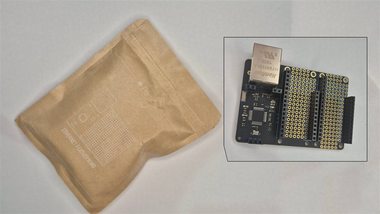

Then came the artisanal style packaging by Particle. Nestled inside the earthy paperish minimal packing was the Matte-Black gold plated PCB just shining there.

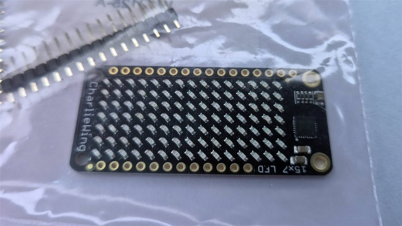

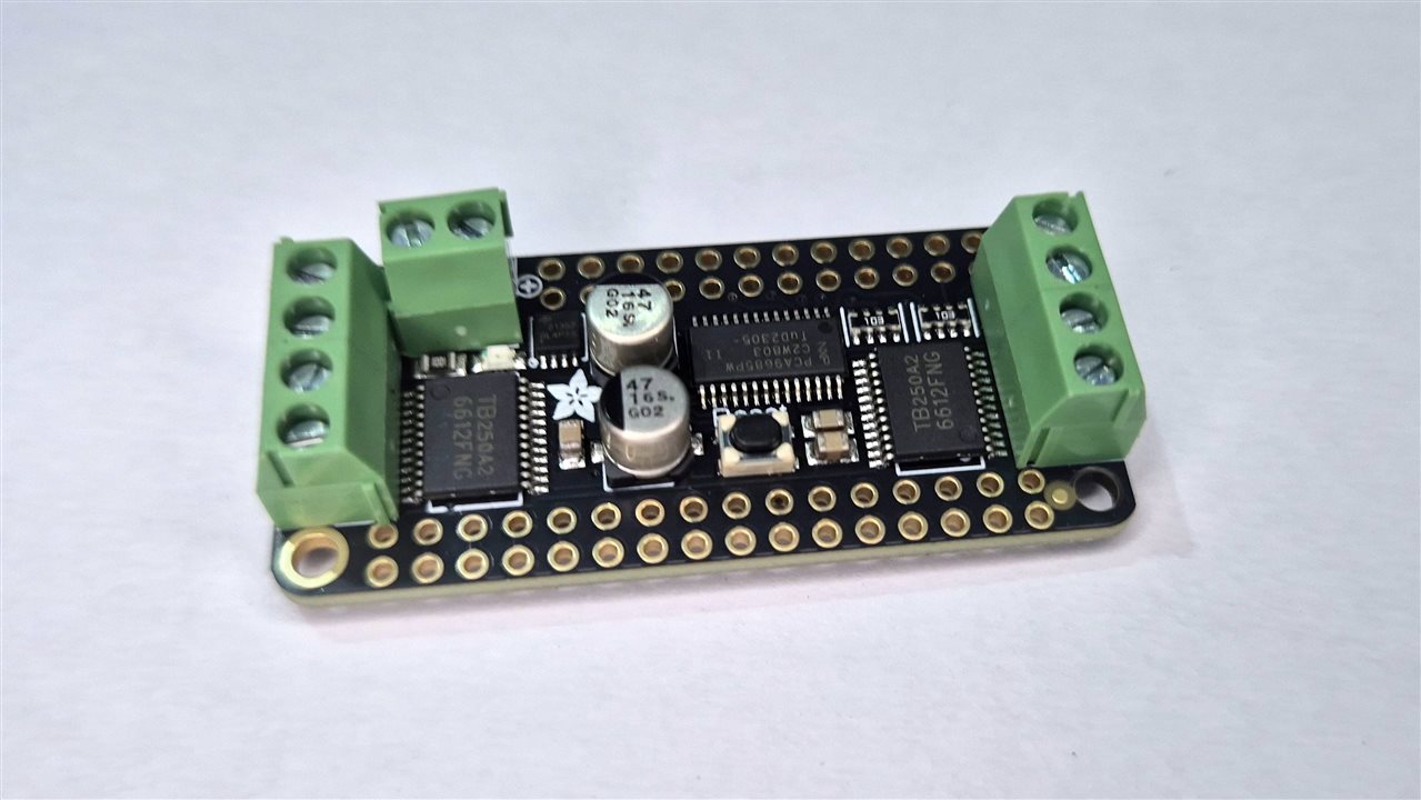

CharliePlex Featherwing and The Motor Control Wing in the Adafruit's classic transparent and Pink zip pouches respectively, The charlieplex LED was red. I would have liked it better with White, but hey it is classic.

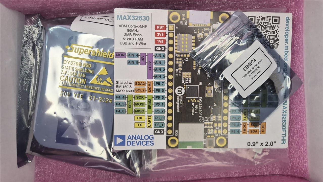

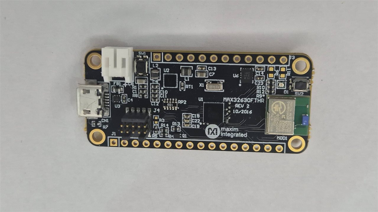

And them deep inside was two white unbranded boxes. Inside them were the power houses MAX63230 Feather Board. i Love them giving the pin out card. Helped me make a header file for the programming so easily and also for quick references.

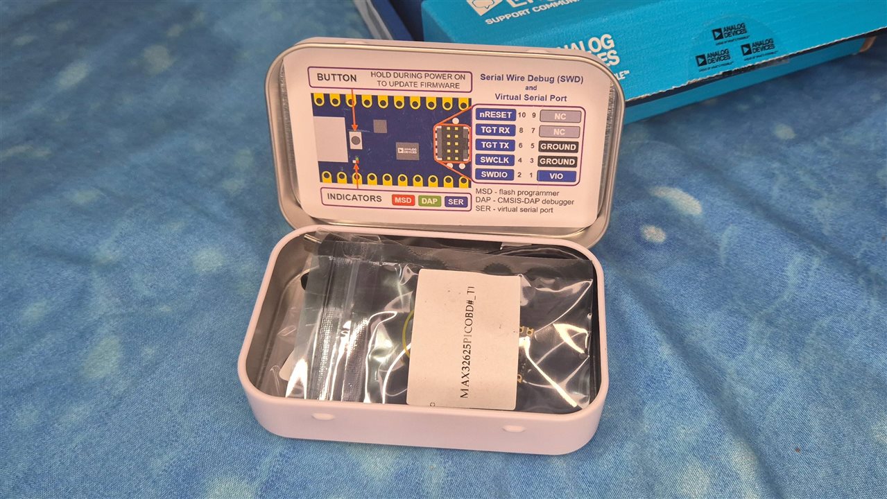

The Programmer was inside an Analog Devices Branded Altoid Tin style box. I would have liked it if not for the fact that there was no ESD padding in the inside. I am gonna reuse the pink one from the outer box. Inside was the Pico Programmer, A Micro USB Cable and the IDC - Ribbon Cable, Even the programmer comes with it's own Pinout card
and finally the Feather board itself.

You have the Eclipse project too. It was a straight forward option to open it, make a blinky compile and then upload it. But then It doesnt work. This is where i spent a lot of time. Now, The SDK ships board support for the EvKit_V1 evaluation kit. The MAX32630FTHR has similar peripherals but different pin connection. The default code is trying to initialize the board with the MAX14690N PMIC over I2CM0 but on the FTHR the PMIC is wired to I2CM2. The I2C transaction waits indefinitely for an ACK, so firmware never reaches `main()`. This happens regardless of whether you build from Eclipse or the command line. it's a firmware issue, not an IDE issue. I switched to command line to keep things simple, but Eclipse works fine too once you configure it as a Makefile project pointing at the LPSDK's own make.exe. So had to override  Board_Init() as below
int Board_Init(void)
 return E_NO_ERROR;   /* skip EvKit PMIC init — PMIC is on I2CM2 on FTHR */
