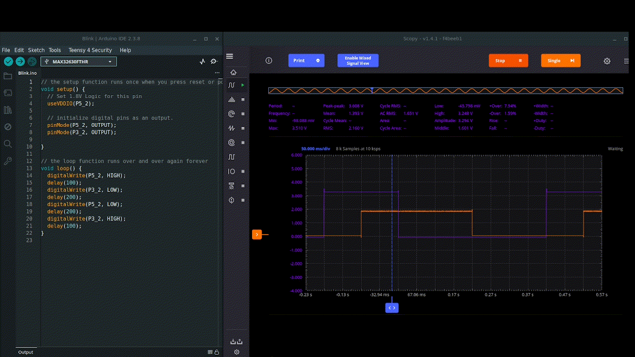

    I noticed that you have not set the pins to 1V8 for the Bluetooth module. Was this intentional? I used useVDDIO(pin_no) to set the BLE pins to 1V8 - alternatively, if you need to switch back you could use useVDDIOH(pin_no) for 3V3. In my opinion, this is one of the very cool unique features of the MAX32630 which is that you can individually define which pin is logic 1V8 versus 3V3. I tested this and it indeed works rather well (video for other readers).

    Finally, great spot with the Errata. I had not seen that. Unfortunately we cannot monitor P1_6 with an oscilloscope. I would be interested to see what effect the P1_7 clock coupling has.
