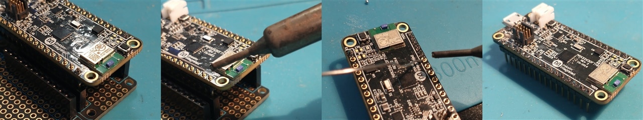

For my project I am using the Particle Ethernet FeatherWing to allow the MAX32630FTHR to communicate with the local network and enable my alarm.
The Particle Ethernet FeatherWing is based around the WIZnet W5500 and under normal circumstances will work with the standard Arduino Ethernet library version 2.0.0+. This is however not compatible with the older Maxim core. It took a while but I worked round the problem, and here is my solution just in case it is helpful to someone else.
Before we get into the software, we need to add some header pins to the MAX32630FTHR. My advice is to loosely place the pins in the FeatherWing and quickly solder on the corner pins. After that the header pins are held in place and the rest of the pins will be so much easier to solder.

So after this modification, and including Ethernet2.h instead of Ethernet.h our standard Ethernet applications will compile but not run. We still need to tell the library what pin to use in our setup code. From the schematic we can see the chip select is on pin 22 if the featherwing connector (traditionally GPIO10) and that is mapped to pin 7 on CON12 (P5.4 /SDIO 2) according to the MAX32630FTHR schematic.
So, in English, just add “Ethernet.init(P5_4);” to setup() before calling “Ethernet.begin”.
