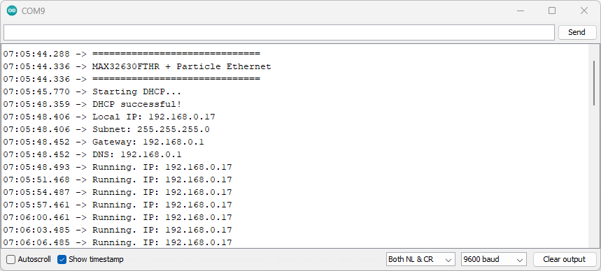

Ethernet
Since we are using the ethernet FeatherWing, there is onboard RJ45 connector with controller. The image below shows the details of the device.
imageThe board is based one the WIZnet5500 and take the form factor of the Adafruit FeatherWing Tripler. It can support
  • 10BaseT/100BaseTX Ethernet
  • Support Auto Negotiation (Full and half duplex, for both 10BaseT and 100BaseTX)
In order to test the ethernet connectivity i have use the following code. And the serial output shows the output. I have also configure the OLED to show the output as well.

The library used is the Ethernet.h. And below is the serial output.
And i have tried to show the status update of the ethernet on the OLED as well
