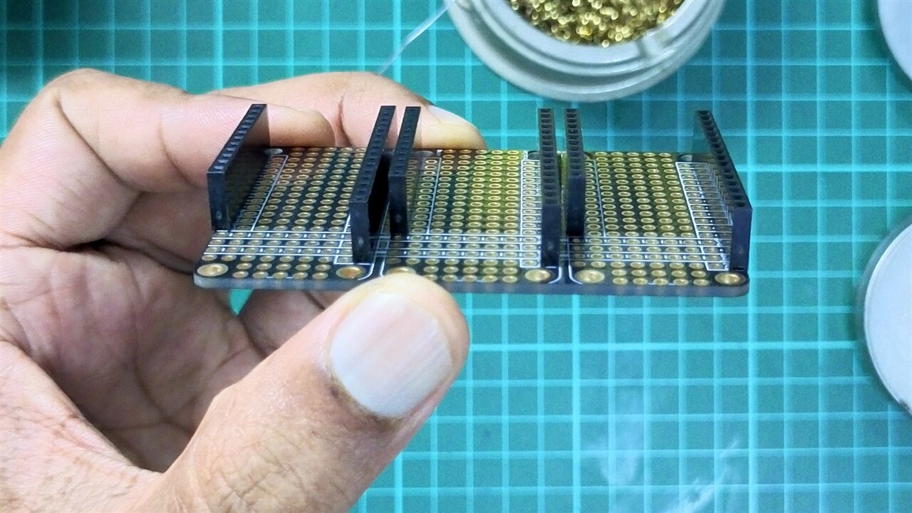

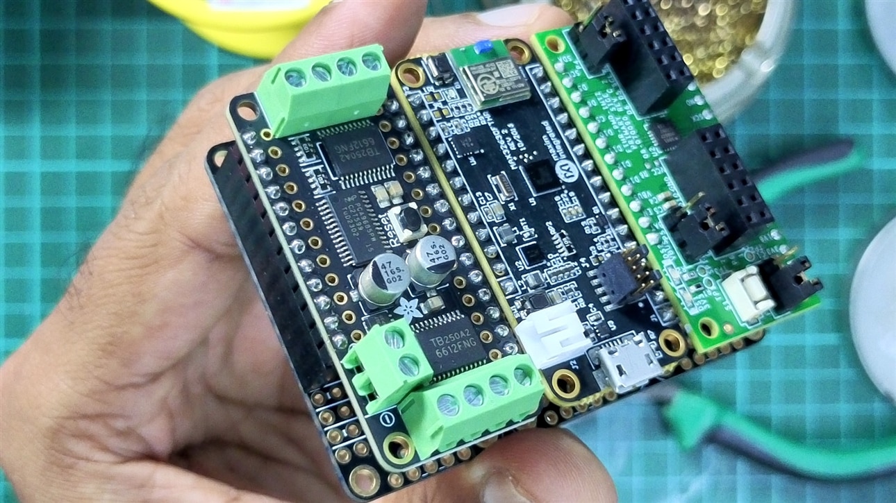

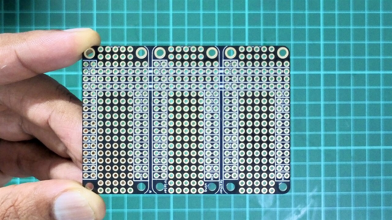

For the slave, i decided to use the similar setup, hence i decide to use the FeatherWing Tripler Mini Kit.

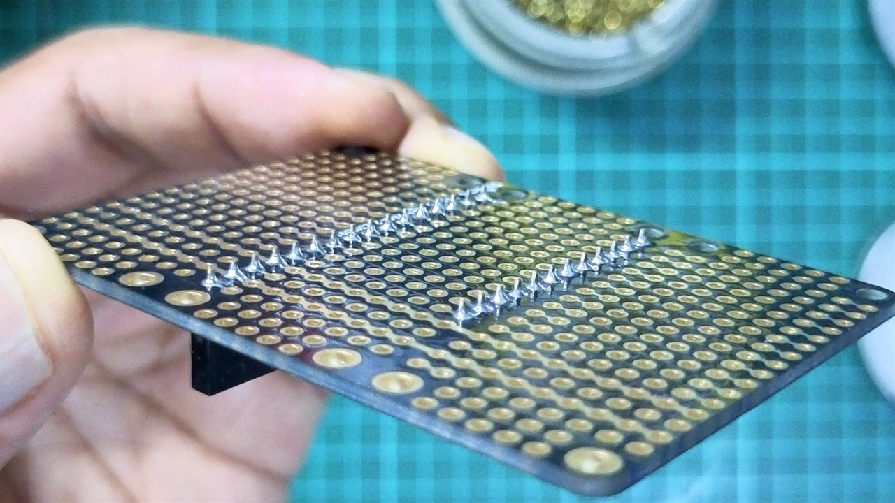

The following image shows the header pins being soldered

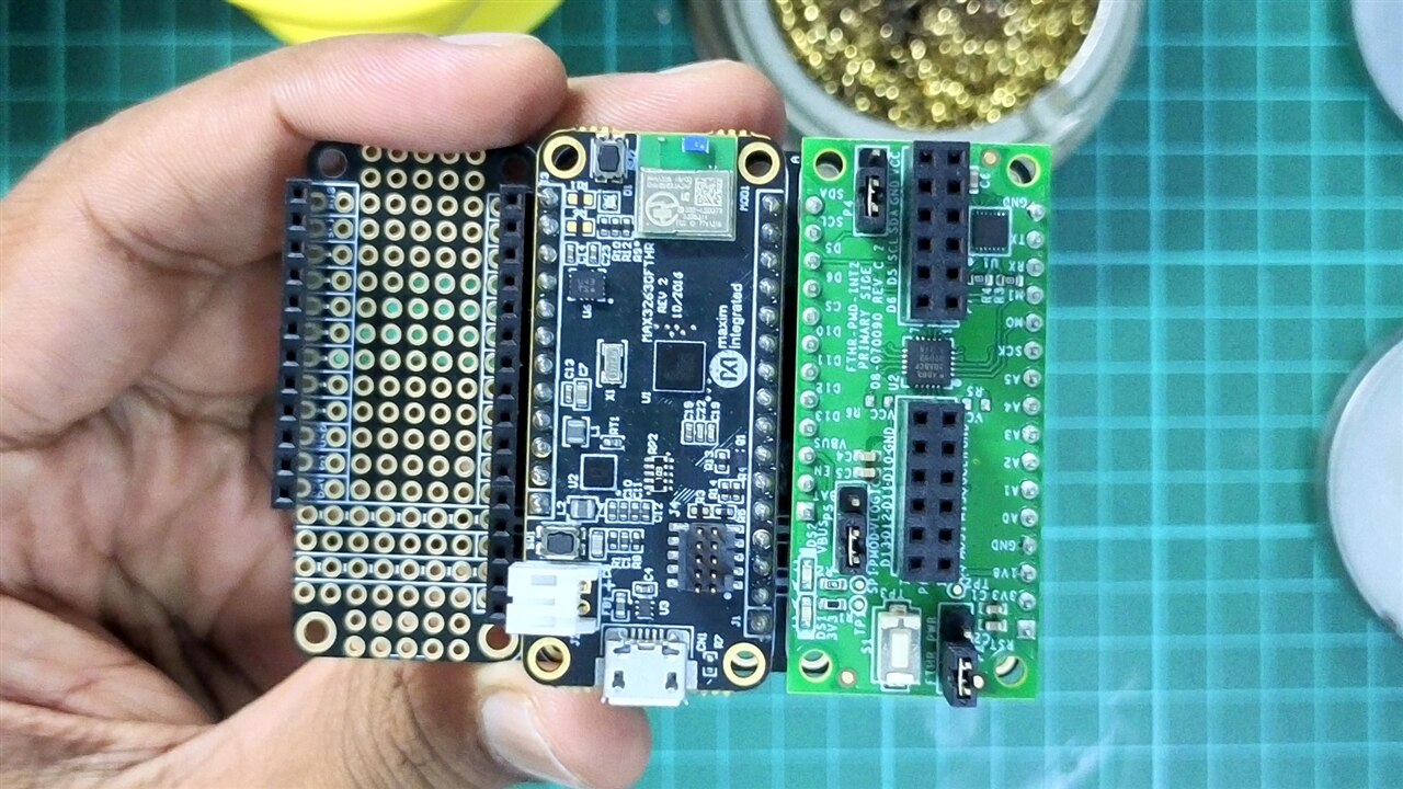

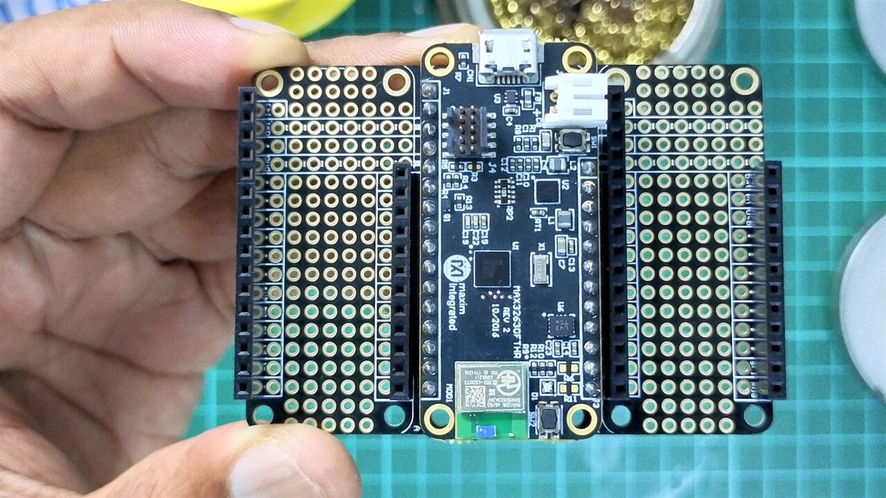

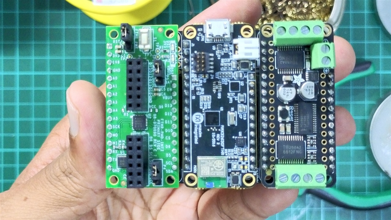

Once finish soldering, I place the MAX32630FTHR in the middle.

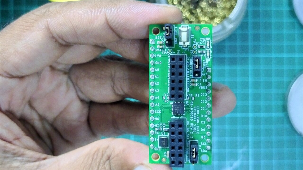

Followed by the FTHR-PMD-INTZ Feather-to-PMOD
Which is place to the right of the MAX32630FTHR

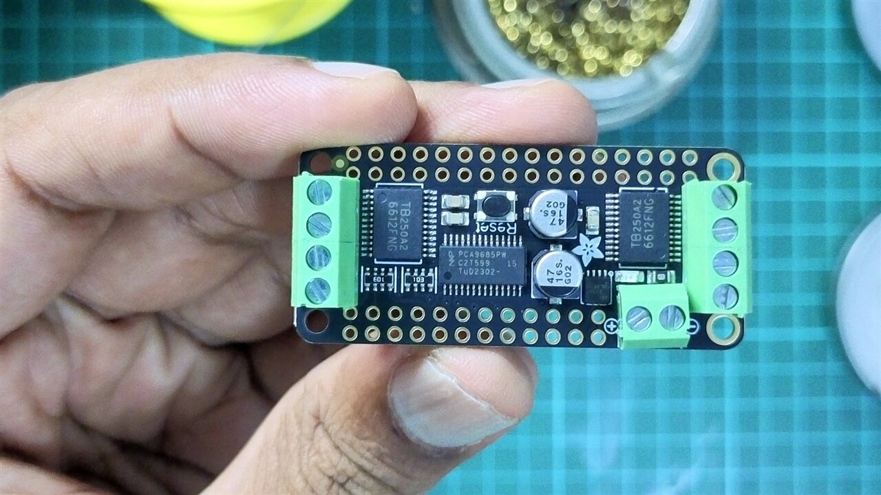

For further info on the FTHR-PMD-INTZ Feather-to-PMOD click here.  Following that, i place the DC Motor + Stepper FeatherWing Addon.
Which is place to left of the MAX32630FTHR
To ensure all the three boards are connected, i did the i2C scanner and below are the result

and the result from the serial monitor is shown below
In the next post we shall see on interfacing with sensor and motor.
