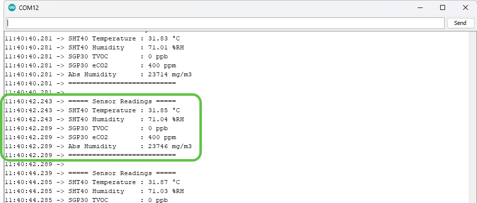

Once we have the i2C address, we can now write the code the read both the sensor values

The output

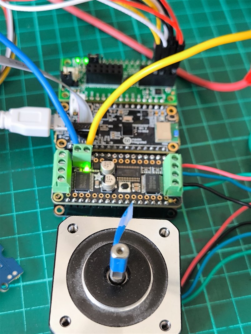

Next we shall see how to interface the stepper motor. Below is the stepper motor i use in this project and the wiring diagram. I am using the stepper motor as shown in image below
The connection between the stepper FeatherWing and the stepper motor is done as shown in the image below
Coil 1 from stepper motor is connected to M3 and coil 2 is connected to M4. Since the FeatherWing has two port, please ensure you are connecting which port. Port 1 is connected with M1 and M2 and Port 2 is connected to M3 and M4. In my case i am using the Port 2. Once the wiring for the motor is complete, connect the external power to power up the stepper motor. And i run the code below to test if everything works fine.

And the video below is the working demo
Now all are working fine. Next is the integration.
