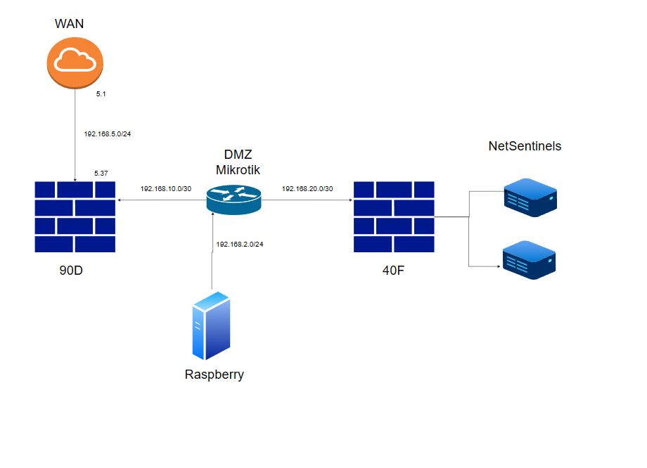

NetSentinel was deployed on a dual-firewall DMZ architecture originally designed for an MSc Cybersecurity lab at Universidad Galileo. This gave the project a realistic enterprise network context rather than a flat home lab.
The topology uses a FortiGate 90D as the exterior firewall, a MikroTik RB3011 as the central routing node, and a FortiGate 40F as the interior firewall protecting the LAN where the MAX nodes reside.
Internet
[FortiGate 90D] — 192.168.10.1/30
[MikroTik RB3011]
    |— ether4: 192.168.2.1/24  ← DMZ
    |   [Raspberry Pi — NetSentinel Core]
    |   192.168.2.200
    |— ether2: 192.168.20.1/30
[FortiGate 40F]
    |— LAN: 192.168.4.0/24
        [MAX Node 1 — Operator Alert Panel]
        [MAX Node 2 — Field Turret Controller]
OSPF Area 0 runs across all three routing devices, providing full dynamic reachability without static routes. The Raspberry Pi in the DMZ can receive syslog and events from all segments but cannot initiate connections toward the LAN — a clean security boundary that reflects real DMZ design principles.
The FortiGates and MikroTik forward syslog to the Raspberry Pi at 192.168.2.200. The Pi processes those logs and determines which events warrant a visual alert on the operator panel.
