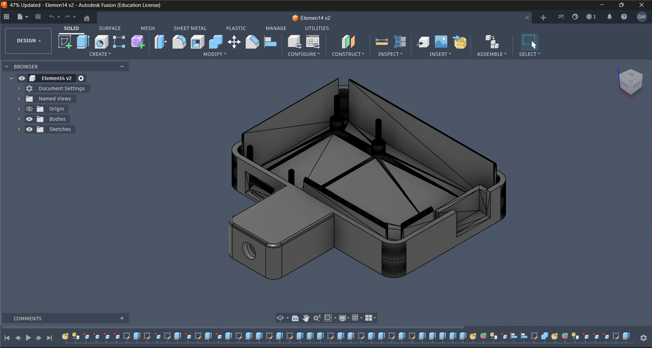

ESP32-CAM Mount — Fusion 360 Modification
The ESP32-CAM mount at the top of the lead screw was designed in Fusion 360. Rather than modeling from scratch, an existing ESP32-CAM case was downloaded as a base and modified directly. The key addition was a square block on the lateral face of the case with a hole sized for the T8 screw — 8.5mm diameter with a T8 ACME thread profile. This block positions the camera at the correct height on the screw and keeps it oriented with the lens facing outward through the sweep arc.
The T8 thread in the printed block acts as the mounting point — the case screws onto the lead screw at the desired height and stays fixed there while the whole assembly rotates with the NEMA.
Cable management for the ESP32-CAM was straightforward: since the ESP32-CAM communicates over WiFi, only two wires run up the screw — power and ground. These were left with enough slack to allow the full 180-degree sweep without binding, and the firmware limits rotation to prevent a full 360-degree turn that would tangle the cables.

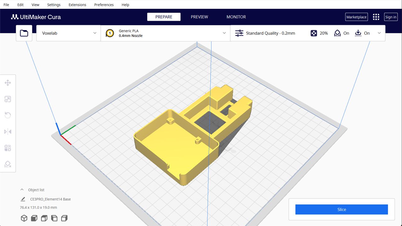

Print Settings — Voxelab Aquila X2
All printed parts were produced on the Voxelab Aquila X2 in PLA. Layer height was 0.2mm for the main enclosure bodies and 0.15mm for the ESP32-CAM mount where the thread accuracy matters most. Infill was 20% gyroid. Print temperature was 200°C with the bed at 60°C. No supports were needed on any of the pieces.
