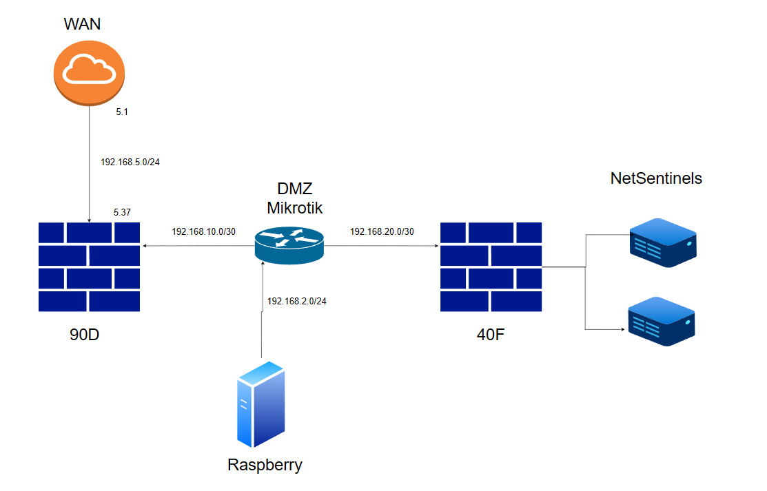

Topology Overview

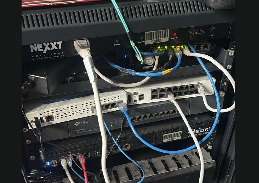

The network was built on infrastructure originally designed for an MSc Cybersecurity lab at Universidad Galileo. Three devices form the routing and security backbone.
The FortiGate 90D is the exterior firewall. It connects to the simulated internet upstream and provides the first security boundary. Its internal interface connects to the MikroTik RB3011 on a /30 transit link.
The MikroTik RB3011 is the central routing node. It has three relevant interfaces: ether1 connecting upstream to the FG-90D, ether4 hosting the DMZ segment where the Raspberry Pi lives, and ether2 connecting downstream to the FG-40F.
The FortiGate 40F is the interior firewall protecting the LAN where both MAX nodes reside.
OSPF Configuration — Area 0
Dynamic routing runs OSPF Area 0 across all three devices. No static routes were used — every segment is reachable through OSPF redistribution.
