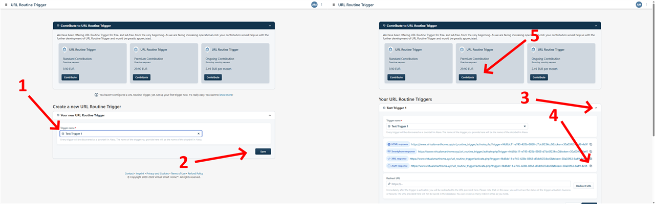

To start go to www.virtualsmarthome.xyz/.../, click the “Login with Amazon” button, and follow the instructions. You will then see a screen like this…
Now (1) enter a name for the virtual button (this can be anything) and (2) click Save. Once created click the down arrow (3) to show the URL information we need, and (4) copy the URL we need to trigger the button and keep it safe. It does not matter which of the URLs you copy as we will not be reading the returned data. Finally consider donating to this service (5) as it exists because of the generosity of the author. If you find yourself using it then do consider making a donation to support it.

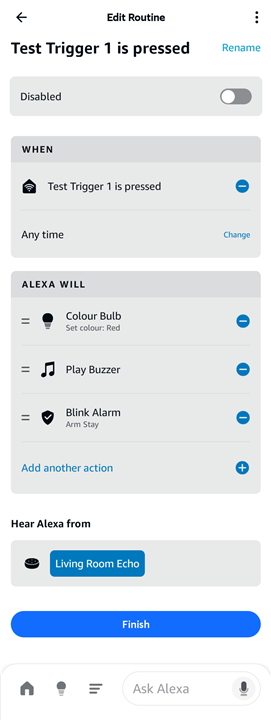

After all that, open the Alexa App, click the “hamburger” button at the bottom, click Routines, and you should find a sample routine that has been created mirroring the name of the virtual button name you entered before. You can then add actions to do by clicking the “+” next to the very descriptive “Add another action” text. Arming an alarm is normally under Smart Home and Security Panels, but that depends on your exact alarm setup.
