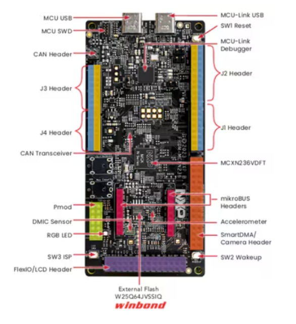

    Built-in 3-axis FXLS8974CFR3 accelerometer, visible light sensor, digital microphone, and supports sensor add-ons via headers.
Pins & Expansion
Both boards offer:
  • 4x Arduino UNO R3-compatible sockets/headers for shields
  • 2x mikroBUS sockets/headers for click modules
  • 1x Pmod header for Digilent Pmod peripherals
  • MCX N236 adds:
    • FlexIO header for LCD
    • Camera header for image applications
    • Dedicated CAN header

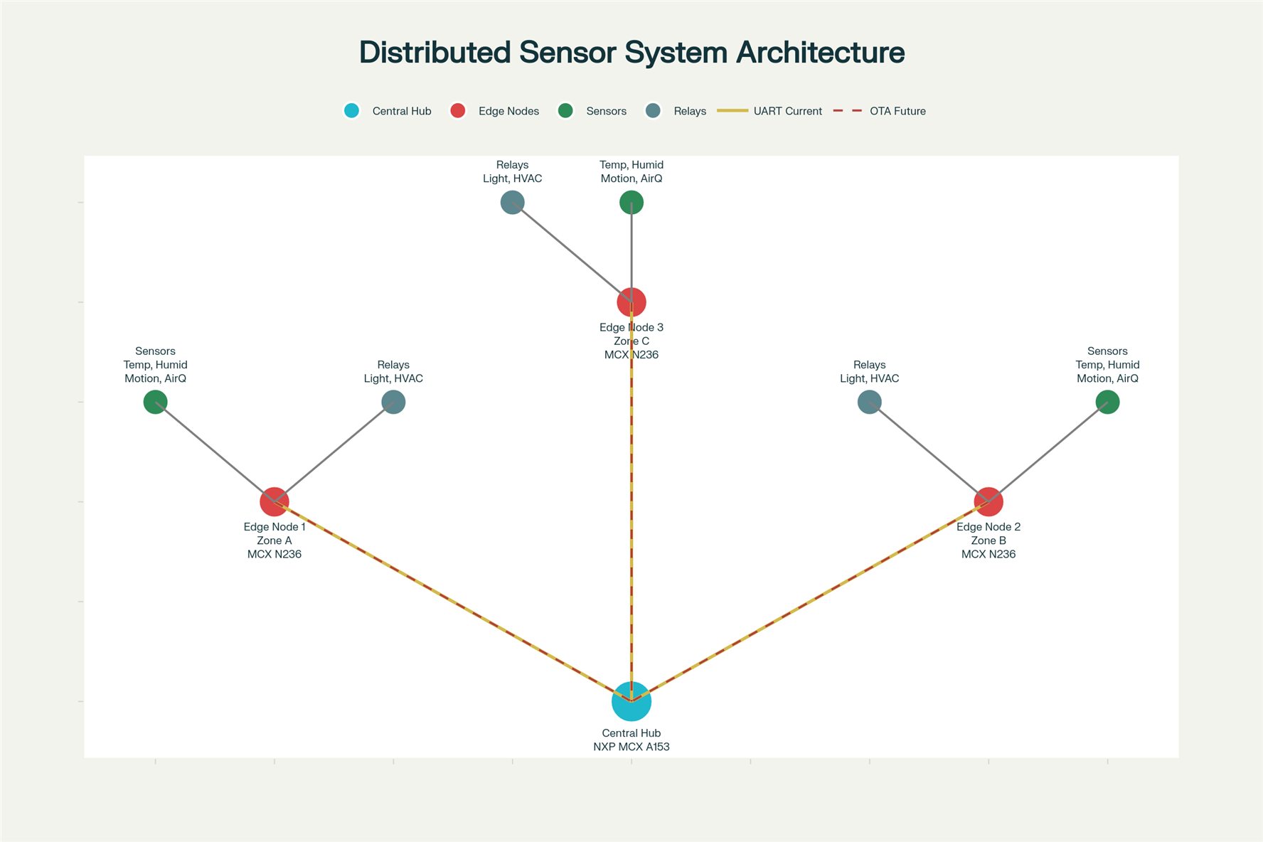

Basic Design
This section gives a basic design for the architecture of the system. The main points are:
  • Central Hub: deploy the NXP FRDM MCX A153 board for serving as the main coordinator.
  • Edge Nodes: Deploy NXP FRDM MCX N236 boards in various building zones to interface with environmental sensors.
  • System Layout: The edge nodes monitor local conditions and relay data to the central hub, which aggregates and acts on this information.
  • Connectivity: initial connect the devices using UART. Then design an over the air solution once connectivity between the nodes is tested and proves to be working.
  • Sensors & Control: Choose sensors for temperature, humidity, motion, and air quality; include relays for lighting and HVAC.
Here is a flow diagram representing the sensor system architecture as described, featuring NXP FRDM MCX A153 as the central hub and FRDM MCX N236 edge nodes. It visualizes edge zones interfacing with sensors (temperature, humidity, motion, air quality) and relays, initial UART connectivity, and the path for future wireless upgrades.

  • Identify the Built-in sensor connectors, FlexIO header for LCD,
    Camera header for image applications, Dedicated CAN header and 64Mbit QSPI flash on the MCX N236 (edge node)
  • MCX A153 (hub)
  • MCX N236 (edge node)

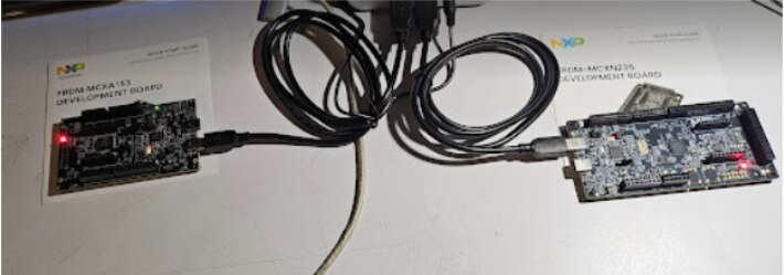

My experience setting up the board development environment involved three key steps: Connecting to Power (plugging in cables, checking LEDs, and confirming PC recognition), Installing Development Software (downloading and installing MCUXpresso IDE and board SDK support packages), and Verifying Board Communication (checking board detection in the MCUXpresso IDE and flashing a demo program). The following sections will describe my journey.

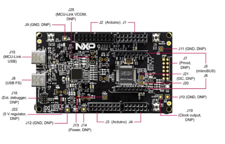

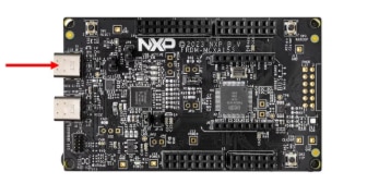

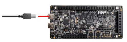

Connect each Board to a PC .Plug In the Board for the:
MCXA153
Power the board via a type-C USB cable from J15 to a PC or power supply, as shown below. The RGB LED should then blink steadily.
MCXN236
To power the board and run the demo program, connect a type-C USB cable from connector J10 to a host computer or power supply, as shown below The RGB LED should then blink steadily.
Showing 2 devices connected to my PC

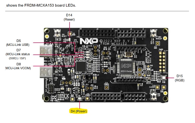

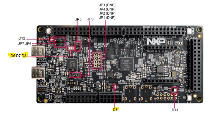

Verify power LEDs
MCXA153
The power LED on the NXP FRDM-MCXA153 development board is labeled as "D4 (Power)"
The power LED is typically green and lights up solid when the board receives power through the USB Type-C connector or other power sources.
MCXN236
The power LED on the NXP FRDM-MCXN236 development board is labeled as "D3" and is green. It lights up solid when 3.3V power (LDO_3V3 supply) is available on the board, indicating the board is powered correctly.

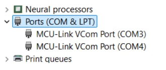

DEBUG INTERFACE RECOGNITION

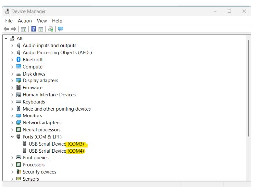

MCXA153 - COM3 :The D8(MCU-Link VCOM) LED (shown above) is a solid GREEN, while the D7(MCU-Link Status) LED is blinking slowly RED. For the Out Of the box demo program LED D15 RGB is blinking
MCXN236 - COM4: The MCU-Link VCOM interface on the FRDM-MCXN236 board is associated with dedicated status LEDs labeled as D8 (red), D6 (green), and D7 (blue). These three LEDs indicate various operational states of the onboard MCU-Link debug/VCOM probe. Specifically, D6 (green) will light up to show active VCOM (virtual COM port) activity, such as when the board is connected and exchanging serial data via the MCU-Link VCOM port. If the VCOM is actively transmitting or receiving, D8 may blink to reflect data transfer, while the other LEDs (D8 red and D7 blue) are used to indicate additional debug status or other probe operations.
For the Out Of the box demo program LED D13 RGB is blinking
The device manager shows the two com ports being used:

This is what device manager now looks like after the install:
The com ports show that MCU-Link VCom is now used for the debugger ports

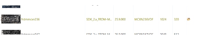

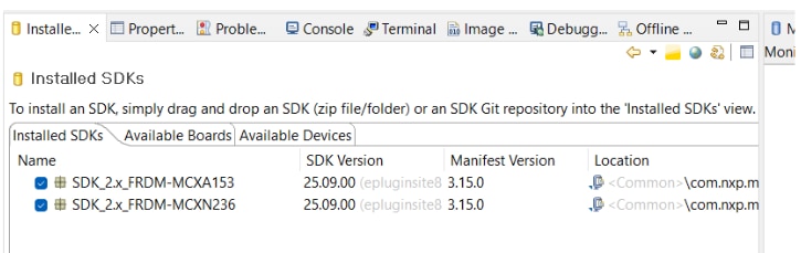

MCUXpresso SDK
Open-source software development kit providing drivers, board support packages, and source code.
NOTE you will need to install the SDK for each device. Select the following from the SDK install. I installed the SDKs from the IDE using the instructions in the video on the  Get Software Page.. Look for the Folder icon on the “Installed SDKs” Panel.
MCXA153
MCXN236
In the IDE “installed SDKs”” you should now see the following:
You will be selecting the SDK for the device you are coding on. This also contains example code for the board you're currently using. More on this later.

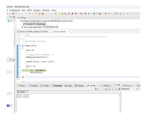

Flash basic test applications (e.g., LED blink, Hello World) to confirm setup.
Follow the instructions on the MCXA153  Build and Run Page for the MCXA153 board. Then, follow the instructions on the MCXN236 Software Page for the MCXN236. They follow the same format but have slight differences for each board.
On this page you'll learn:
  • To import an SDK example (like hello_world) into MCUXpresso IDE.
  • The guide walks you through selecting the FRDM MCX board, expanding the demo_apps category, and choosing hello_world.
  • You’ll build the demo and set the debug console to UART for serial output.
  •  Steps include connecting the board via USB MCU-LINK port, flashing the application, and selecting the MCU-Link CMSIS-DAP debug probe. NOTE – Be sure to include the Instructions for opening a serial terminal (settings: 115200 baud, 8 data bits, no parity, 1 stop bit) are provided. Also, make sure you select the right Serial port (COM4 because my MCXN236 is connected to it ) for the device. You'll need to open a new terminal session to have this dialog come up. I made the mistake of using the terminal fro  a previous run on the MCXA153, and there was no output displayrd.
  • image
  • Finally, you will run the demo and see terminal output.
By completing the instructions on each device page , you will understand how to build, flash, and run sample applications on both NXP devices using MCUXpresso IDE or other supported toolchains, and how to monitor output through a UART serial connection.
I tried the “hello world example” on both devices to get a feel for developing on two devices from the same IDE on the same PC. I followed the instructions from the “Build and Run Page” outlined above.

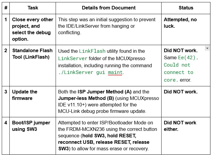

The only section I was able to complete was section 4.1. All the other sections had documentation errors. As I described above. But I get the general idea on using the IDE.
I was unable to complete Section 4.2 able to clone, configure, and enhance example LED projects. But since I will not be using 3rd party IDEs, I
I was also NOT able to finish section 4.3 and 4.4 on Pins configuration, manipulate pin routing, extend code capabilities, and visualize changes with additional output hardware, due to errors between the page content and the actual code in the SDK examples. So save you time and review these sections and if you can figure out the differences to see if you figure it out.

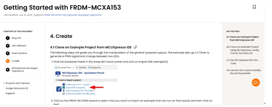

MCXA153 Create Page
Follow the instructions on the MCXA153  Create Page for the MCXA153 board.
Here’s what you can learn from Create Page:
  • How to clone and modify SDK example projects:
    • In section 4.1 Clone an Example Project from MCUXpresso IDE :
      • You’ll import and run the ctimer_match_interrupt_example—a demo that sets up a PWM signal to switch between RED and GREEN LEDs using the CTimer peripheral.
      • You’ll learn how to select the UART debug console to observe output.
  • Using MCUXpresso Config Tool for third-party IDEs:
  • Working with Pins Tool in MCUXpresso IDE:
    • In Section 4.3 Use MCUXpresso IDE Pins Tool
      • You’ll learn how to use the IDE’s Pins Tool to view and edit pin routing, specifically for the ctimer project. In
    • Section 4.4 Use the Pins Tools to Modify the LED Routed Pin:
      • You’ll learn how to Modify routed pins to enable more LEDs:
        • Step-by-step directions show you how to enable and configure additional pins (e.g., for the BLUE LED), making changes in the Pins Tool and updating your project code.
        • You’ll export modified pin configuration files, add macros to initialize and control more LEDs, and ensure the GPIO peripheral is reset for new output.
    • PROBLEMS IN DOCUMENTATION
      • In section 4.4 steps 7 and 8
        • Step 7 does not have the defines in the simple_match_interrupt.c
      • Step 8 Does not have the Code specified and the arrow pointing to the code has an unreadable Argument and I’m not sure where to place the code in the main function.
    • Building and running after modifications.
    • The guide has you build and flash the updated firmware, resulting in the board blinking GREEN and BLUE LEDs back and forth.
    • I was never able to get the code running, so I could not verify this statement.

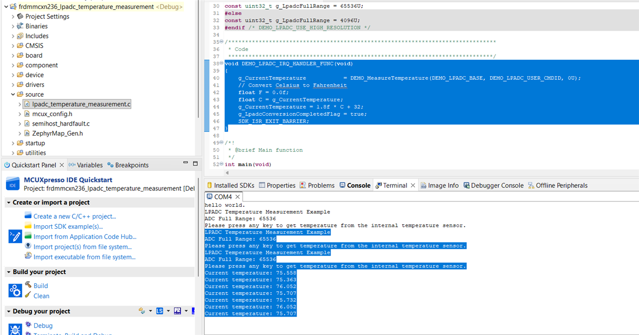

Sensor & UART Integration and Testing
This section will detail the use of the MCX N236's built-in sensors (temperature, motion, and light) and the UART on both the MCXN236 and MCXA153. It will cover utilizing the Sensor and UART demo projects in MCUXpresso IDE for data reading/writing and operational verification, as well as troubleshooting wiring and initialization.

There is NO onboard sensor for temperature. You’ll need to connect one MIKEO etc, there is an MCU temperature example {Lpadc_temperature_measurement} where you can get the temp of the MCU. SO I used that as an example The next section describes my finding. I did run into some problems with the Debug Probe, which was very frustrating.

  1. Connect a USB cable between the host PC and the EVK board J10.

At this point I was receiving the following error when I tried to debug on my MCXN236:
 Ee(42). Could not connect to core. and No connection to the chip's debug port.
I eventually figured it out and was able to continue with this project If you get this error , refer to this forum link  NO connection to chips debug port on the MCXN236: for details.
Convert Celsius to Fahrenheit
To convert 22.7°C to Fahrenheit use this formula:
Fahrenheit = 1.8. * Celsius + 32
Change output to Fahrenheit
follow the following instructions to make changes to the program
  1. Locate where the temperature value is calculated
    1. In the main code file lpadc_temperature_measurement.c there is an interrupt function DEMO_LPADC_IRQ_HANDLER_FUNC(void).
    2. After the line
g_CurrentTemperature = DEMO_MeasureTemperature(DEMO_LPADC_BASE, DEMO_LPADC_USER_CMDID, 0U);
    1. ADD the conversion to modify the global variable g_CurrentTemperature
         // Convert Celsius to Fahrenheit
         float F = 0.0f;
         float C = g_CurrentTemperature;
         g_CurrentTemperature = 1.8f * C + 32;
Follow the steps above to build, debug the project and run it
Conclusion
Results of the run showing temperature in farinheight. you have now modified your first example. I will use this program in my implementation.
LPADC Temperature Measurement Example
ADC Full Range: 65536
Please press any key to get temperature from the internal temperature sensor.
Current temperature: 75.558
Current temperature: 75.363
Current temperature: 76.052
Current temperature: 75.707
Current temperature: 75.732
Current temperature: 76.126
Test a UART connection between the N236 & A153
Connect the UART via USB cable or pins on each device
Write a test program that will send and receive messages between both.
SDK example found : lpuart_polling
Example also on challenger site: https://community.element14.com/challenges-projects/design-challenges/smart-spaces-design-challenge/f/forum/56339/dds-elevator---hello-world?ReplySortBy=CreatedDate&ReplySortOrder=Descending
PSDO CODE
The program contains 2 shareable functions Send and Receive.
The SEND() will send a message
The REVEIVE() will get the message and display it on the terminal screen.
On the MCX N236 (edge node)
Send a message or the value of a sensor.
On the MCX A153 (hub)
Receive the message
System Communication Test
Wired test: Connect MCX N node to MCX A hub via UART as planned. Flash demo code where sensor data is forwarded from N to A and printed via A’s UART.
Node recognition: Confirm that MCX A parses distinct node IDs and logs received values to terminal or onboard LCD.
Network expansion (optional): Attach additional MCX N boards to simulate multi-zone coverage. Confirm unique data from each node.

1. Plan Network Architecture
  • Deploy MCX A as the central hub, aggregating sensor data from MCX N nodes.
  • Deploy MCX N as a edge node.
  • Define message payloads for various sensor info, edge node ID etc. for data movement between hub and edge nodes.

  • I am currently facing a critical and complete standstill in my project development due to a severe and unresolved issue with the MCXN236 device. Refer to this forum link  NO connection to chips debug port on the MCXN236: for details
    To be absolutely clear, this development board or component is entirely non-functional; it is, in effect, a useless brick. All attempts to utilize the device have failed, rendering it completely unusable for its intended purpose. Consequently, I am dead in the water, as the lack of a working MCXN236 has created an insurmountable bottleneck, making any further progression on my project impossible until this fundamental hardware issue is resolved. This is not a minor setback; the device is fundamentally broken and cannot be leveraged for any stage of my necessary development work.
    Here are the four troubleshooting steps I attempted to fix the "No connection to chip's debug port" error with your NXP FRDM-MCXN236 board, along with the reported status for each:
