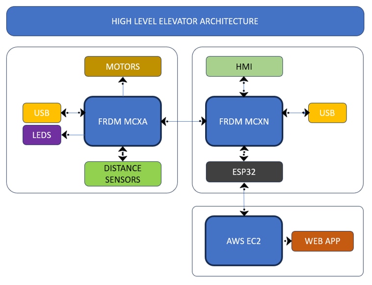

Planned Architecture
My original proposal included creating a 3-lift model, digital twin and analytics application to facilitate preventive maintenance.
Initially I wanted a distributed system where each Microcontroller has a specific function. FRDM-MCXN236 with its higher processing power will be main controller which will be used to control the MCXA153 board which will control the motor, LED indication, monitor the distance at which the lift is in, and report to MCXN236. MCXN236 will share the telemetry using ESP32 which facilitates the network option.
Since the MCXN236 is also peripheral rich and comes with CAN supports, flexible number of UART, I wanted to make use of at least one peripheral of each type.
UART – Communication between MCXN236 and HMI display
SPI – Communication between MCXN236 and MCXA153
CAN - Communication between MCXN236 and ESP32
I2C - Communication between MCXA153 and ToF sensor
When I made these decisions, I didn’t factor in complexity of enabling and using these peripherals for the purpose they are made.

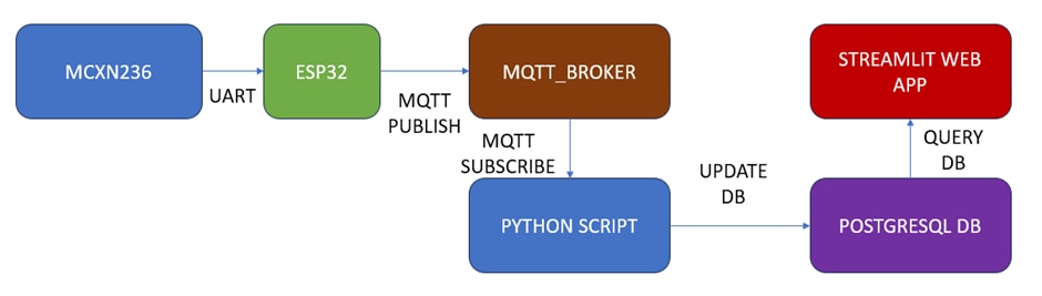

Web App
The idea is to gather the telemetry data from the lifts and analyze, present it in a dashboard. The data can further be used to optimize the logic the lift operates so that if any particular lifts is repeatedly used more than other, it can be avoided.
An ESP32 Dev Kit board will be used to get the lift events from MCXN236 board. The data will be in a binary code format with each byte denotes the floor number, whether its travelling to a particular floor, whether there are any faults. The data will be transmitted to a MQTT broker. A python script will continuously monitor the particular topic and once the message is received, it will parse the binary data to its proper definitions. Then it will push the data entry to postgresql db.
The web app is actually a python software created using Streamlit library. Streamlit library provides a faster way to visualize data by integrating various libraries like matplotlib, plotly. The Streamlit application will frequently query the database and update the dashboard. Below are the videos of simulated data to check whether the web app is working.
The below is a video of transmitting simulated lift data using MQTT
 Below is the video of a python script that subscribes and receive the mqtt messages and push into database.
Below is a video recording of streamlit app that fetches the data from Postgresql db and create charts based on it.

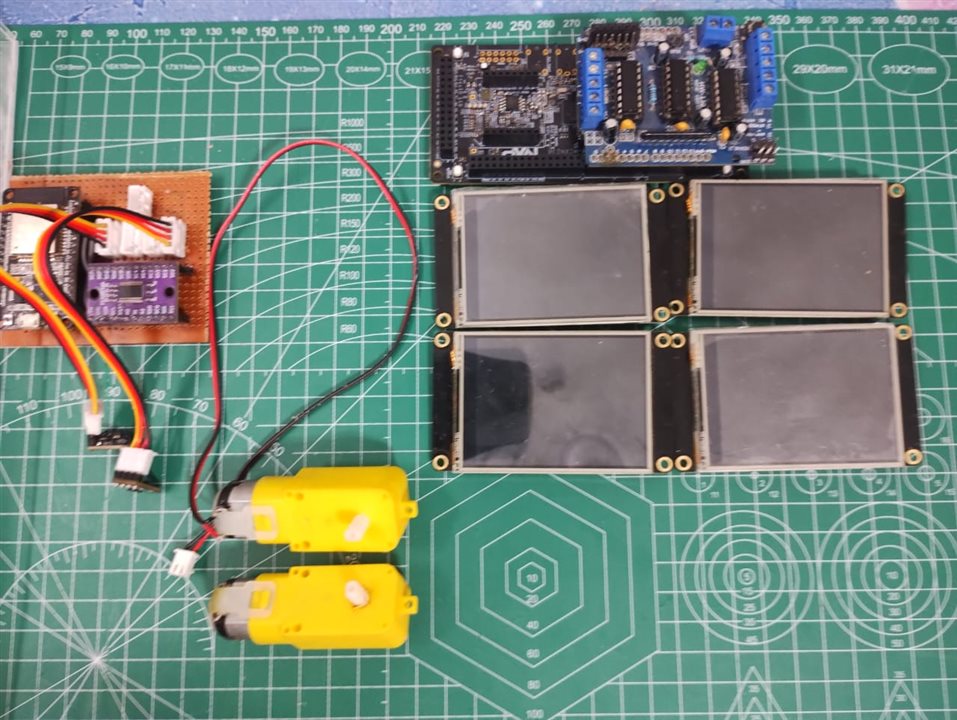

Once the components are selected, I started exploring the SDKs and programmed the devices without using example code. It is at that point troubles started happening. Most of the examples uses a default peripheral instance and those worked without any glitch. Enabling another instance of same peripheral family started introducing new issues which took some time to resolve.
When working in non-blocking mode, we could receive only 4 bytes of data during interrupt operation which is not enough for receiving data from HMI (13bytes)
For example, the automatic code generation for LPUART assumed all UART will use the same code which was not the issue for certain pins which are configured as UART.
DDS Elevator - Enabling LPUART in N236 board for Serial communication - element14 Community
Sometimes, the IDE will stop working when flashing the firmware and requires a separate flashing tool. This stops us from using simple debugging procedures.
Besides these, introducing multiple controllers increased the complexity of the project. It is at this point few weeks ago, I decided initial architecture plan won’t work at all.
