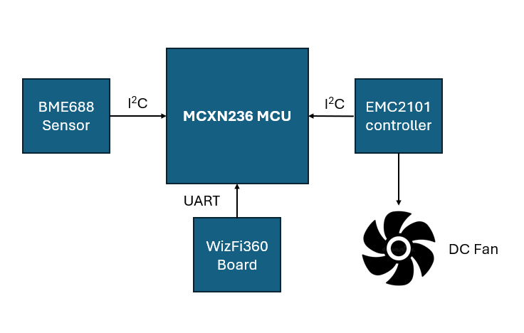

This section documents the details of the low power and smart exhaust fan operation.
  • The BME688 sensor measures the volatile organic compound levels (VOCs) and sensitive to a range of VOC compounds. It interfaces with the MCU via the I2C interface (LPI2C2) and its device address is 0x77.
  • The EMC2101 controller is responsible for controlling and operating a DC fan. It interfaces with the MCU via the I2C interface (LPI2C2) and its device address is 0x4C.
  • The WizFi360 shield is used to send data and receive commands from the cloud. The shield interfaces via the UART interface.
  • The FRDM-MCXN236 is at the heart of this project. It makes use of the BME688 sensor data and runs a TinyML algorithm to detect odors. Based on the odors detected and/or air quality levels, the MCXN236 operates the DC fan using the EMC2101 controller. It makes use of the WizFi360 to upload data and receive commands via the UART interface.

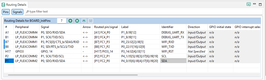

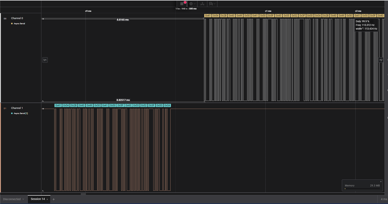

The WizFi360 shield is interfaced to MCXN236 using LPUART1 (via LPFLEXCOMM1). It makes use of the Arduino shield pins D7 and D8. The shield is used to upload data and receive commands from the cloud. The challenge encountered while interfacing the shield was getting the UART interface working to send AT command. With the help of the logic analyzer, it was determined, there was no output on the UART interface. As mentioned in this post, the UART interface LPUART1 worked only when it was configured as follows:
status = LP_FLEXCOMM_Init(LPUART_GetInstance(base), LP_FLEXCOMM_PERIPH_LPI2CAndLPUART);
instead of
status = LP_FLEXCOMM_Init(LPUART_GetInstance(base), LP_FLEXCOMM_PERIPH_LPUART);
To avoid breaking the auto-generated code, the UART initialization sequence in lpuart.c was modified as shown below.
#if !(defined(LPFLEXCOMM_INIT_NOT_USED_IN_DRIVER) && LPFLEXCOMM_INIT_NOT_USED_IN_DRIVER)
/* initialize flexcomm to LPUART mode */
if(base==(LPUART_Type *) LP_FLEXCOMM1_BASE)
else
if (kStatus_Success != status)
return status;
#endif /* LPFLEXCOMM_INIT_NOT_USED_IN_DRIVER */
It is not clear why this modification was necessary. After the modification, the UART interface was operational. The logic analyzer output below shows the AT commands and their response via UART. The AT commands driver was ported from here.

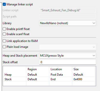

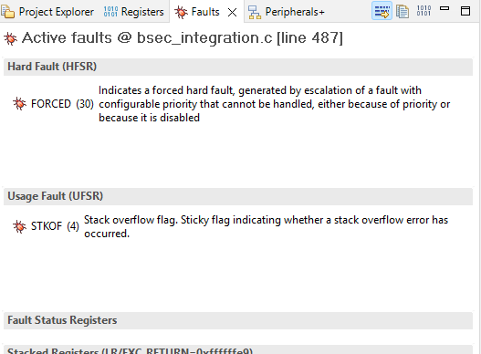

The BME688 breakout board is interfaced to the MCXN236 via LPI2C2 (configured via LPFLEXCOMM2). The drivers for the BME688 were available from here and here.The biggest challenge with interfacing this sensor was the stack requirements. Initially, this project was kicked off with the FRDM-MCXA153 board. But there wasn't enough memory and resulted in a stack overflow (as documented in this post).
Even after making multiple attempts, it was very difficult to get the sensor interfaced to FRDM-MCXA153.
After switching to FRDM-MCXN236, the stack size had to be increased to 16kB. It was smooth sailing after bumping up the stack size and the FRDM-MCXN236 was a perfect fit for the sensor.
