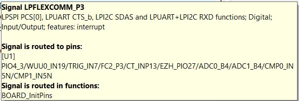

I used the SDK examples to configure LPUART with my MCXN236 project. I think there is a bug in Flexcomm initialization inside LPUART_Init(). LPUART_Init() is auto generated by the SDK.
I was not able to get LPUART working when Flexcomm was initialized as follows inside LPUART_Init():
status = LP_FLEXCOMM_Init(LPUART_GetInstance(base), LP_FLEXCOMM_PERIPH_LPUART);
I was able to get it working when I configured it as follows:
status = LP_FLEXCOMM_Init(LPUART_GetInstance(base), LP_FLEXCOMM_PERIPH_LPI2CAndLPUART);
What might be the reason for this?

    When I hover over the MicroE extension Rx and Tx pins, I get this information "LPUART+LPI2C RXD" & "LPUART+LPI2C TXD" You are correct, those Rx and Tx works only if "periph" parameter is set as " LP_FLEXCOMM_PERIPH_LPI2CAndLPUART…

  • balajivan1995
    balajivan1995 over 1 year ago
    Are you trying to enable second UART on MCXN236? I faced similar issue as well when trying to enable the UART pins on Arduino Header and MicroE headers. In the end, I ended up using the UART pins available on LCD display headers.

  • balajivan1995
    balajivan1995 11 months ago
    You are correct, those Rx and Tx works only if "periph" parameter is set as " LP_FLEXCOMM_PERIPH_LPI2CAndLPUART". But setting like this caused my default UART to fail. So, I modified the code like this
    if(base==(LPUART_Type *) LP_FLEXCOMM2_BASE)
    else
    Now I could use both UART without any issues.
  • yamanoorsai
    yamanoorsai 11 months ago in reply to balajivan1995
    But it didn't work for me when I tried to initialize LPUART1. I had to use:
  • yamanoorsai
    I had to do the same thing that you did. Thanks for sharing.
