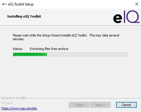

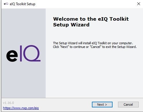

1 Install eIQ
Download and install eIQ from NXP website

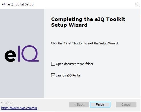

The plugins and install packages are extracted, installed and configured.
Until the installation complete.

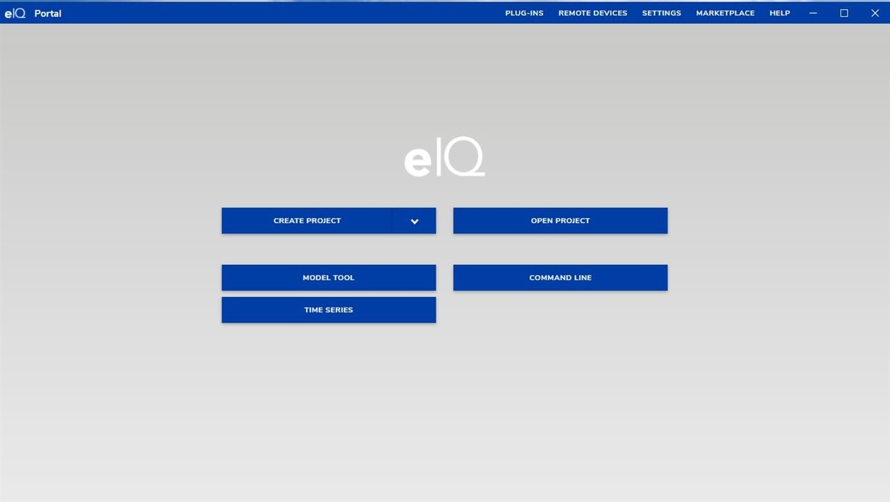

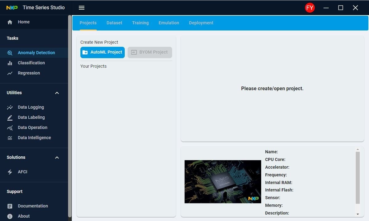

2 Start  eIQ

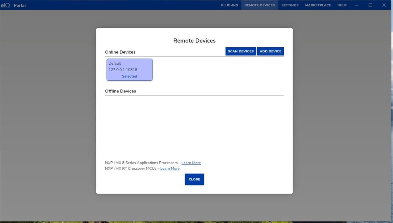

Start eIQ and enter welcome page for different components,
Remote device like USB camera can be added for image capture for dataset

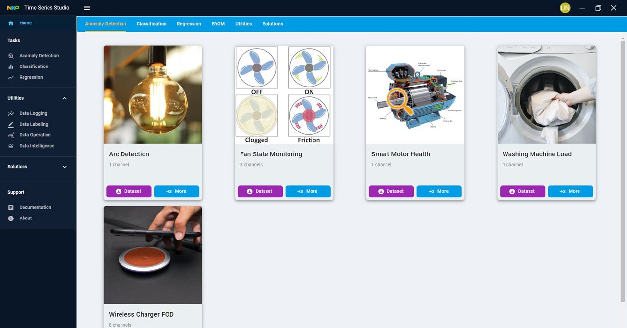

This is Time series studio for  time-series dataset, training with many model available to use.

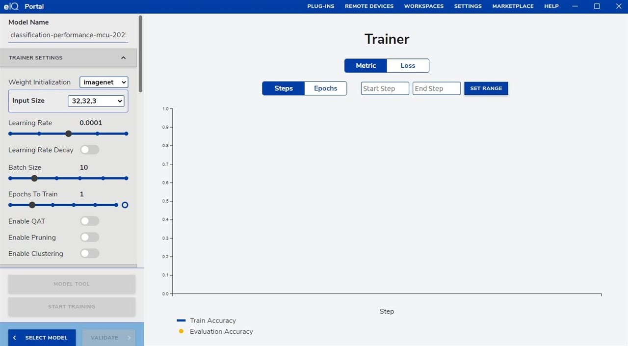

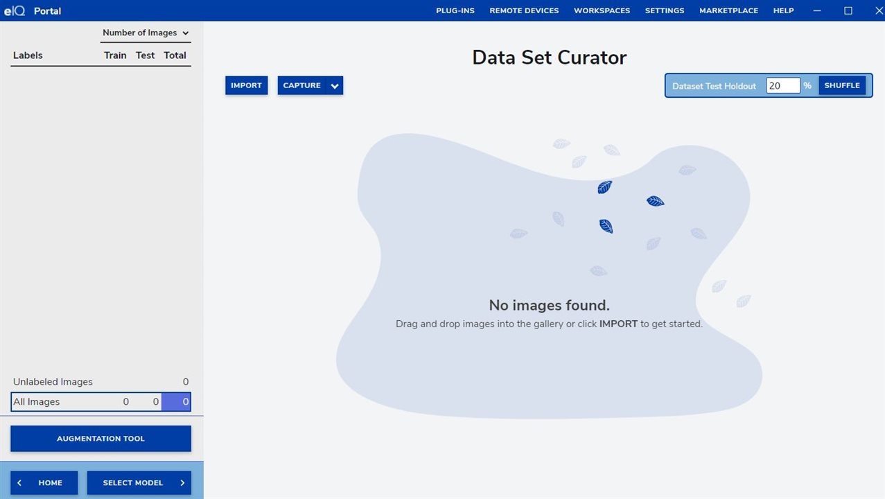

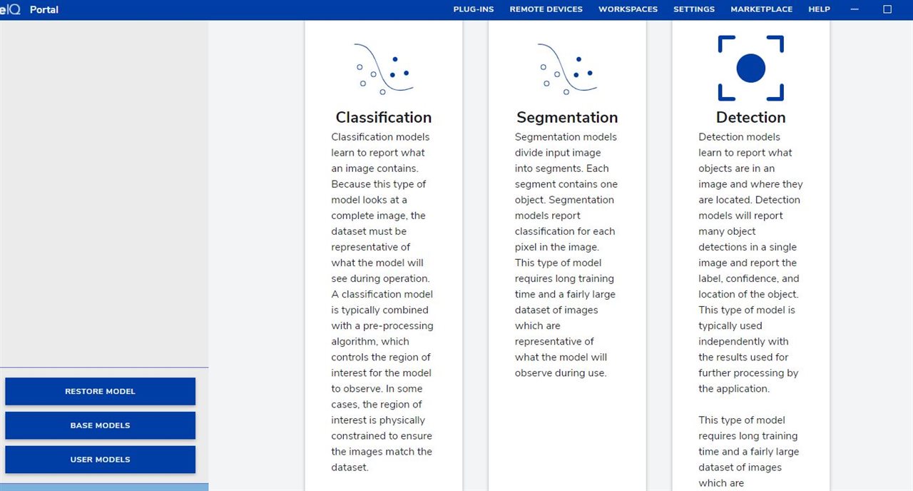

The create new project can create new project use images,
now, only three model is supported
After model is selected, the UI appears for dataset import and model training

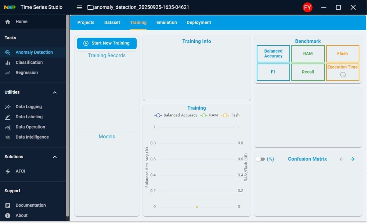

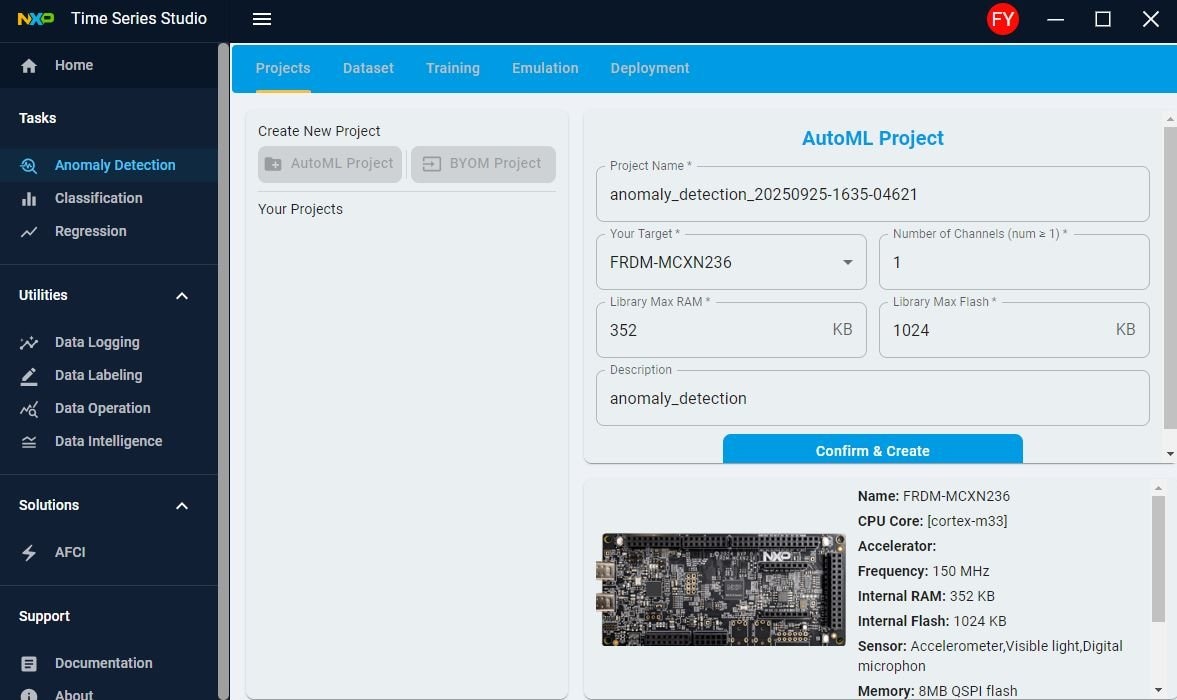

3 Use time series studio
Create new project
select hardware, now FRDM-MCXN236 and not support  for FRDM-MCXA153

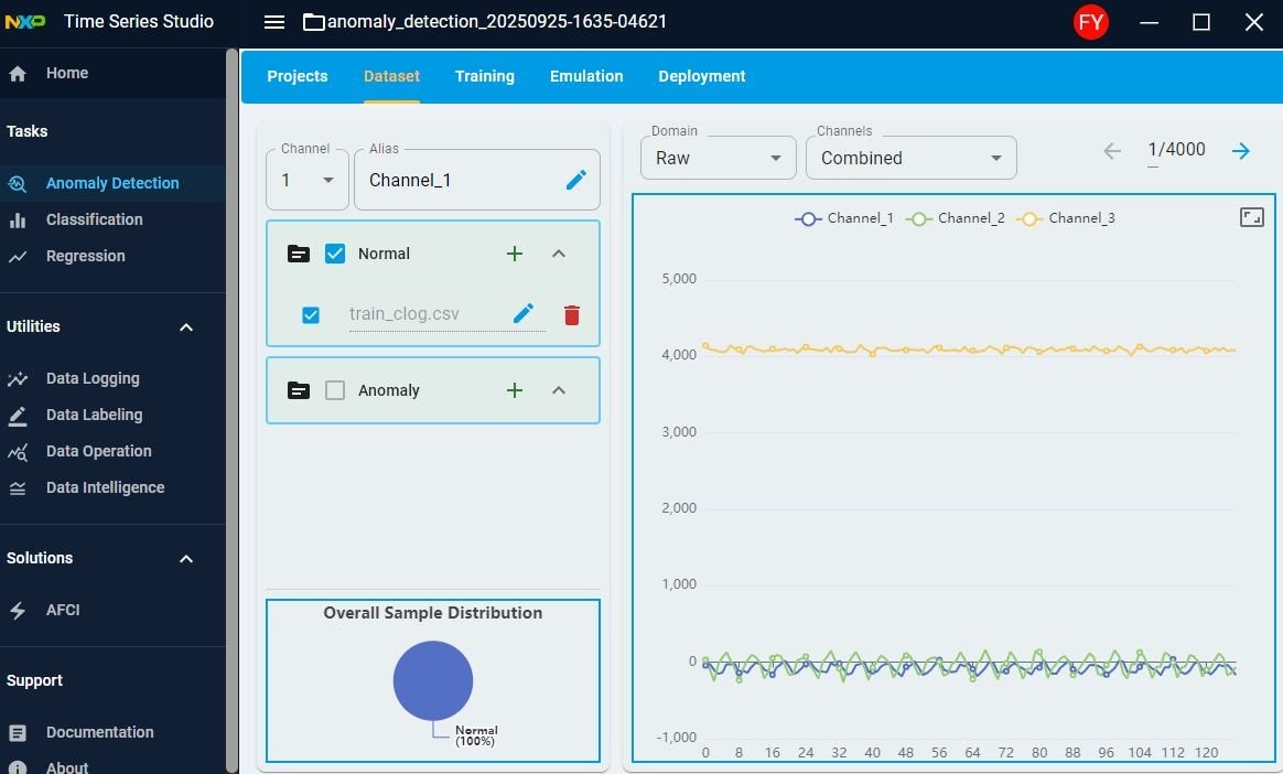

then select raw data which is in csv format or txt format, there are three channel created,

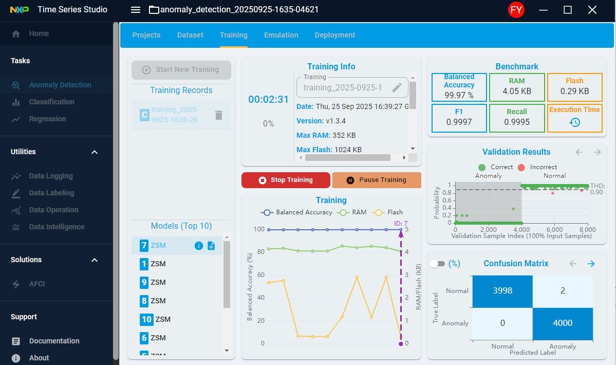

start training, with memory allocation shown.
the train in progress,
with training process in active windows

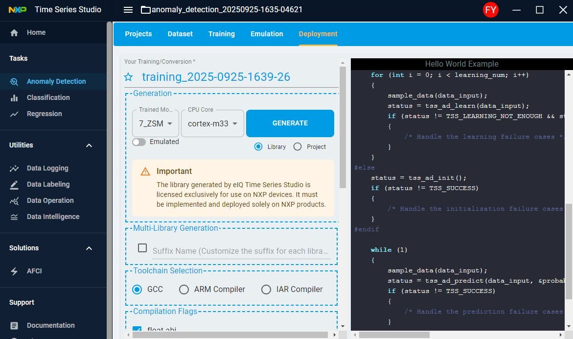

after the training completed, deploy the result , generate files to embedded in the project or direct generate one project.
This is how the eIQ shall be used in designing and the toolkit is well and easy to be used.
