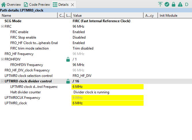

I am trying to configure LPTMR0 for a 1-second interval. I followed the lptmr example in the SDK examples to configure my timer. The interval at which the interrupt is generated never correct.
Here are the steps I followed:
  • Configure the LPTMR0 clock source to 96MHz with a divider of 16. The clock frequency for LPTMR0 is 6MHz.
  • After code generation, I set the timer count to 6,000,000 for 1 second interval.
I confirmed that the timer is a 32 bit timer. The timer does work but the interval duration is not 1 second. It is something else.
Did I skip a step in configuring the timer?

    This is how I confirmed that the clock frequency is 6MHz. I took the 96MHz clock and divided it to 6 MHz.

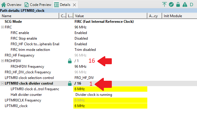

    Just for curiosity. Try swap 16 and 1 dividers:

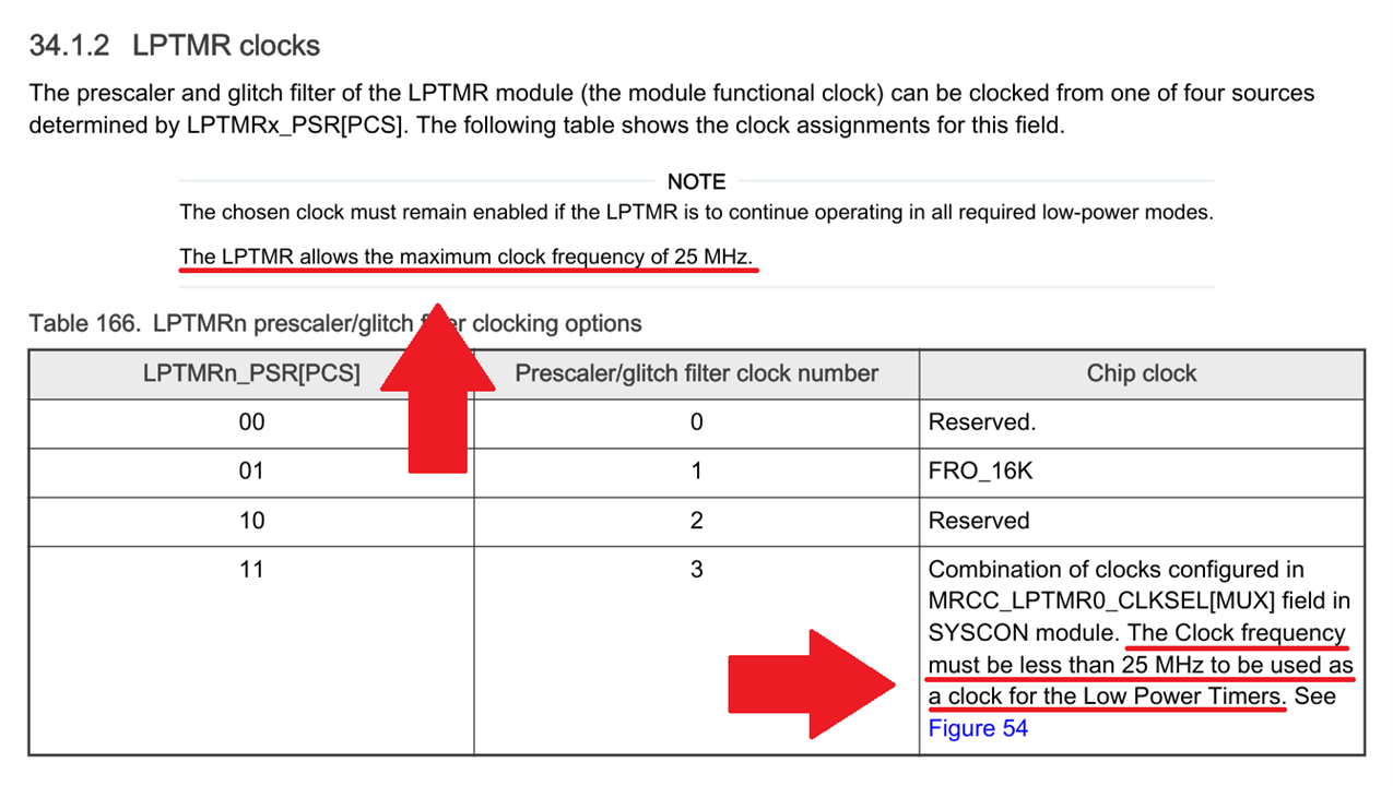

    According to Technical Reference Manual, LPTMR support up to 25 MHz on input. How do you know that "clock source is 96MHz"? Do you see it somewhere in GUI config in development environment? Could you post screenshot? If not in GUI, could you post code?
