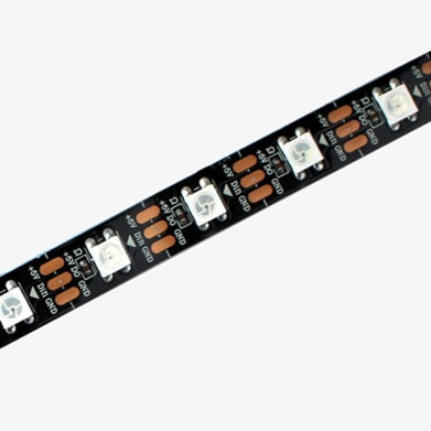

Imagine for a single floor, we need 4 buttons to get user input on floors, 1 RGB led with different light configuration for different statuses. That makes each floor requiring 5 GPIOs. Now, for our lift model, we have 4 floors and that makes 16 buttons to get user input and 4 RGB LEDs. We could reduce the number of GPIOs required by 4*4 matrix keyboard and bit addressable RGB LEDs. That still requires up to 9 GPIOs.

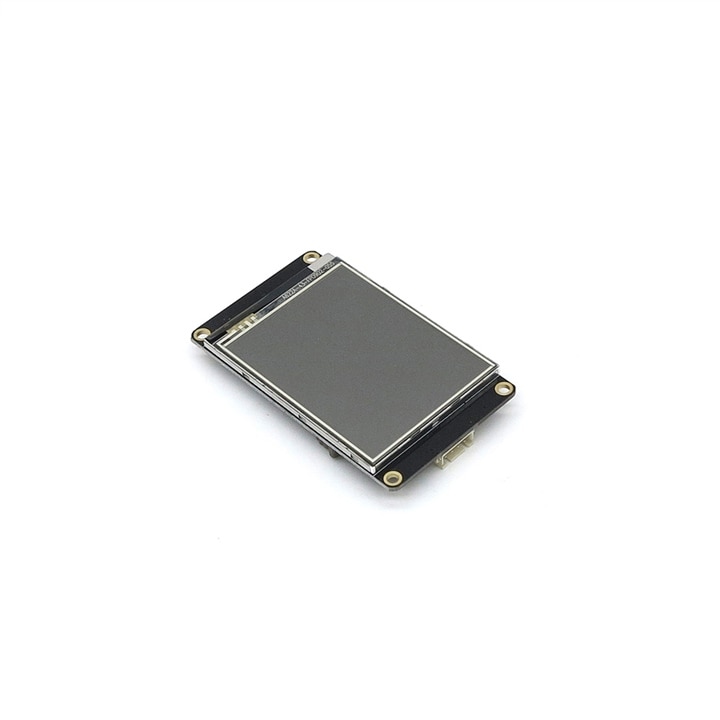

Now, HMIs on the other hand, depending on the model can be operated by using just UART alone. That’s just 2 GPIOs for one floor, 8 GPIOs for 4 floors. Since it is a touch supported HMI, we could get user input and provide feedback on display.
For this project we will use a 2.8” touch display from Nextion Brand. It is a resistive touch display and cheaper.

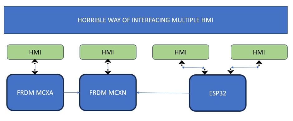

Since we have finalized to use 4 HMIs, we need to look for ways to minimize the number of wires. Each HMI comes with 4 pins – Vcc, Gnd, Rx, Tx. Supply and ground wires can be taken parallelly from a power source. But we still need to route 8 wires for UART.
Initial idea
My initial horrible plan was to make use of multiple MCUs each reporting back to MCXN236 board. MCXA153 has one extra UART port, ESP32 has 2 extra UART ports, and with one already working UART from MCXN236 combining all these resources we could wire something like this.,
Just looking at the above block diagram made it obvious this is a ridiculous way of connecting multiple HMIs, so I dropped this idea and decided to try an alternative.

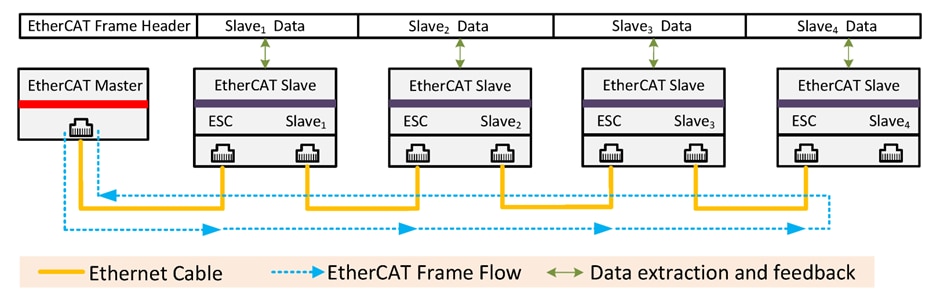

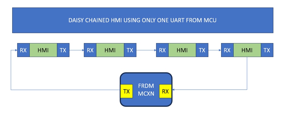

Daisy chaining
Daisy chaining is a simple interface method where we connect multiple nodes in a linked list manner. I got this idea from Ethercat communication which uses two ethernet port, one will act as input and other as output.
The Ethercat master will send a process image, with request to fill the process image with data from slaves or update the slaves from the process image. By slightly modifying this for UART, we can use Tx as output port and Rx as input port.

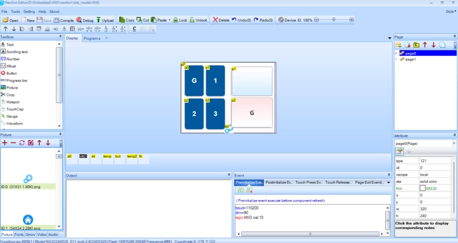

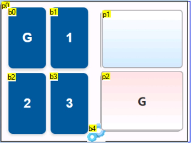

Programming the HMIs
Nextion provides an application called “Nextion Editor” which can be used to design the UI. It also provides simulation mode to immediately visualize the changes.
Since steps to cover how to program an HMI display out of topic for this post, I will add few links in reference.

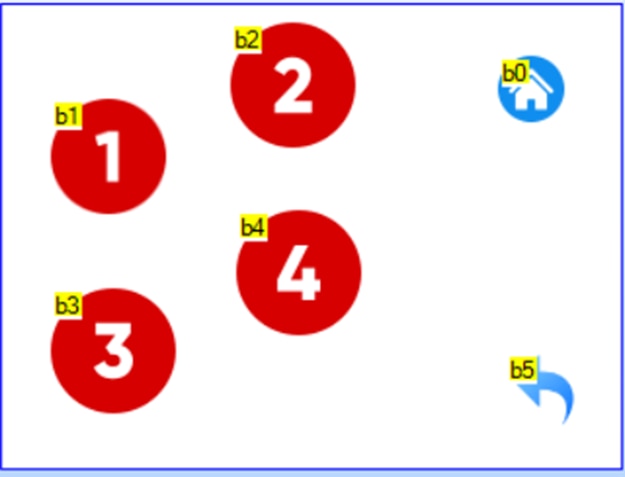

UI – Dynamic Floor selection
Instead of programming each HMI display with a different identification number, I have decided to create a configuration page where the floor in which display will be placed can be selected.
Values start with 0 for button 1, 1 for button 2 and so on. For example, on pressing the number 4, the value “3” will be written to memory ().
wepo 3,10
wepo is the write to EEPROM memory command, 3 is the identification for 4th floor and 10 is the address we are writing to.
On pressing the home icon, the HMI will restart. On initializing, it will read from memory address 10 and store the floor value in a variable for further use.
repo liftID.val,10
repo is the read from EEPROM memory command to read from the memory address 10 and store into variable called “liftID”.
