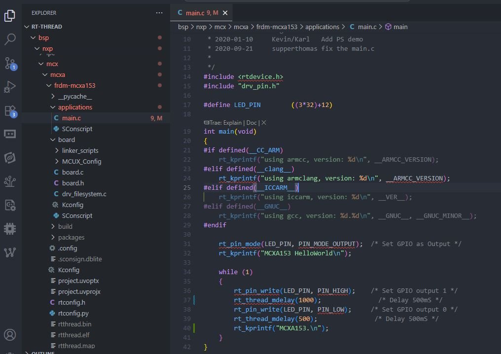

Here is the code main.c
#include <rtdevice.h>
#include "drv_pin.h"
#define LED_PIN        ((3*32)+12)
int main(void)
#if defined(__CC_ARM)
    rt_kprintf("using armcc, version: %d\n", __ARMCC_VERSION);
#elif defined(__clang__)
    rt_kprintf("using armclang, version: %d\n", __ARMCC_VERSION);
#elif defined(__ICCARM__)
    rt_kprintf("using iccarm, version: %d\n", __VER__);
#elif defined(__GNUC__)
    rt_kprintf("using gcc, version: %d.%d\n", __GNUC__, __GNUC_MINOR__);
#endif
    rt_pin_mode(LED_PIN, PIN_MODE_OUTPUT);  /* Set GPIO as Output */
    rt_kprintf("MCXA153 HelloWorld\n");
    while (1)
        rt_pin_write(LED_PIN, PIN_HIGH);    /* Set GPIO output 1 */
        rt_thread_mdelay(1000);               /* Delay 500mS */
        rt_pin_write(LED_PIN, PIN_LOW);     /* Set GPIO output 0 */
        rt_thread_mdelay(500);               /* Delay 500mS */
        rt_kprintf("MCXA153.\n");

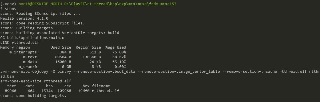

3 Build the project with scons
output the rtthread.efg

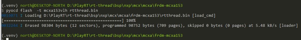

4 Flash the board
Flash the board, use pyocd since the MCU-Link is CMSIS-Dap compatible,
Now it is ready to restart the board for result.

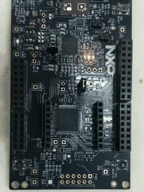

5 Run with the blinky
Here is the result.
