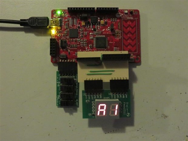

I made my own Pmod adapter PCBs to enable the connection of multiple Pmods to the Pioneer Kit.
Pictured above is the adapter I designed for the PmodSSEG a Dual 7 segment LED display used in conjunction with a PModSWT (4 switch module)

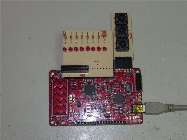

Pictured below is own Pmod compatible board to add some additional Tact switches to the Pioneer Kit and Pioneer LED board.
