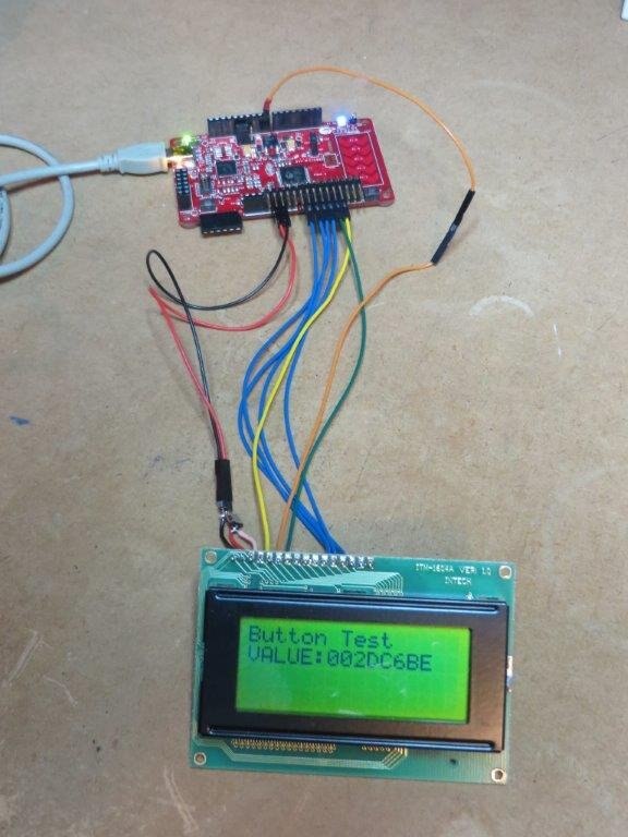

This is a self contained project that demonstrates how to use the Timer component to measure the duration of a button push.
It is one of my tests of the Timer (2.5) component.
This picture may look simple but there's a bit going on here:
     The Timer (2.5) component is configured as a resettable One Shot Timer with trigger and capture
     The Timer is triggered upon the depression of the push button
     The capture is performed upon the release of the push button
     The timer is rearmed on demand
     I'm using a 4x16 LCD Character Display.
The Character LCD Component is used but according to its datasheet it is only designed to operate with a 16 x 2 line LCD display.
To make it work with the particular 16 x 4 display some adjustments are required:
  1. 5x7 font.
  2. 4 lines
My adjustments have been engineered not to require any changes to the component's source code. They are;
1. Font selection -  The appropriate configuration bit requires adjustment.
The initialisation requires the following to be added immediately after the LCD_Char_Start() API.
     LCD_Char_WriteControl(LCD_Char_DISPLAY_2_LINES_5x10 & ~(0x04));
(Note: Ideally, the 0x04 numeric constant should be replaced with a suitable symbolic constant).
2. Cursor positioning - The additional two lines reside in the memory space of the first two lines.
This is a rather simple adjustment using a wrapper function.
     void MC_LCD_Char_Position(uint8 x, uint8 y) {
          if ((x >= 2) && (x <=3)) {
               LCD_Char_Position(x - 2, y + 16);
          } else {
               LCD_Char_Position(x, y);
There is a limitation to the use of the  Character LCD component. All of the interface pins must reside on consecutive pins on the same port.
If you look at the photo above you will notice that I have connect the LCD component to Port 2[6:0]. Pin 2.6 is on the far side of the PCB relative to its sibling pins so it is connected with an extension lead.
During my research I spotted an error in the component datasheet so I hope someone from Cypress will revise it with the correction.
That is the description of Constant LCD_Char_DISPLAY_2_LINES_5x10 in the table.
What reads as;
    "Set display to be 2 lines 10 characters"
should read as;
    “Set display to be 4-bit interface, 2 lines of 5x10 pixel characters.”
Enjoy the short video!

    COMPACT over 12 years ago in reply to cy.gul +1
    Gagan, I used the debounce component in the project. Cheers Very Comapct

    oops, i should read the schematic before I jump to the comments section! image

    Gagan,
    I used the debounce component in the project. image
    Cheers
    Very Comapct

    Or you could use the "Debounce" Component in PSoC Creator to do this for you! =)

    Hi Don,
    Yes it still works but for this test I've used the default 24MHz source clock for the Timer. This is able to detect very short intervals including key bounce.
    I haven't tried reducing the source clock frequency for the timer to see if I can remove the debouncer.
    The good ol' method of a RC network could also be used to remove key debounce but that would add a component or two.
    Cheers
    Very Compact

    Hi Monte,
    I wondered if you need a switch debounce circuit.
    Have you run your timer test without it to see how noisy the switch change is?
