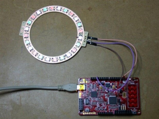

I'm sick of blurry photos and flash photography going wrong so I quickly constructed this Camera Lens lighting ring.
It should work with my digital still and video cameras.
It consists of 24 RGB LEDS which are individually controlled by a PSoC 4.
All designed, made and constructed in hours!
It was the very first fully rotational axis PCB I've made and I am happy with the result and It works a treat.
Unlike a standard white only LED light with a fixed illumination level this design with RGB LEDs that are current controlled allows me to control output intensity and colour supposedly without any flickering.
Also unlike a normal LED light I can control combinations of LEDS to get different effects such as alternating LED colours or even alternating on / off and so on and so forth.
I was toying with the idea of hemispherical and selected sector lighting too.
I just can't wait to test it out and see what effects I can get.
P.S. The spare pin enables additional modules to be connected such as additional lighting and axis pan and tilt.

    COMPACT over 12 years ago in reply to vsluiter
    Hi Victor,
    Thanks for the link.
    I think it confirms that the PSoC 4 with WS2812Bs is a much simpler method of accomplishing a similar result.
    Very Compact

    DAB over 12 years ago
    Nice work Monte.
    I wonder if the LED's might be too bright.  I would consider adding a diffusing piece of plastic.
    Try using the nice flexible material from an old dead LCD screen.  That stuff makes great light diffusers.
