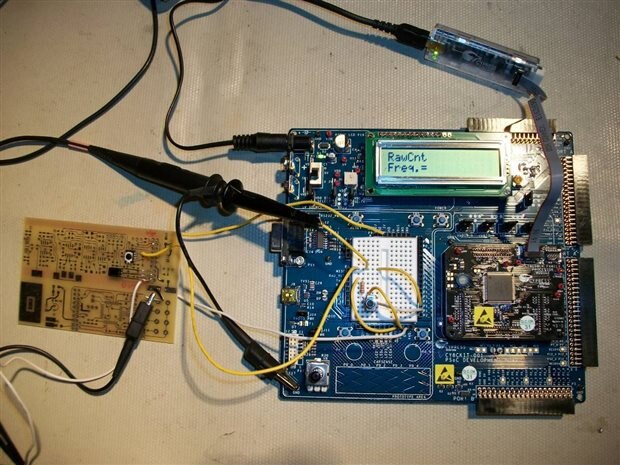

After getting familiar with the Cypress evaluation kit I resumed my work on the brainwaves appliance controller.  I connected the infrared sensor to one of the pins of the PSoC5LP kit and on the little breadboard I constructed a push button that pulls high to 3.3V another pin, as I am showing in the figure below.

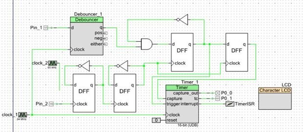

On the left side of the PCB there are two infrared sensors, one with a decoder, which I connected to an oscilloscope and I use for reference, and one that provides the raw signal including the carrier, which I connected to PSoC5LP.   When I push the button the program enters into code learning mode.  In this mode I need to implement two functions: 1. Measure the infrared carrier frequency and 2. Decode the infrared signal into a sequence of logic high and logic low pulses and to store that information.  So far I was able to make the first function work.  Here is the schematic of the blocks inside PSoC5LP.
The infrared transmitted signal starts with a preamble square wave signal at the carrier frequency.  I take this signal through pin 2 and I divide it by 4 in order to average four periods and increase the accuracy of my measurement.  There are at least six pulses of the preamble signal over all infrared transmission protocols that I saw so far, so I am safe to average the first four.  I then use the rising edge of the divided signal to trigger a counter that runs at a bus speed of 24MHz and the falling edge to capture the count value.  The counter starts from a predefined value of 35535 and decrements it on each rising edge of the 24MHZ clock.  On the falling edge of the measured signal I set the counter on sleep mode and I read the count value.  I then subtract this count value from the starting value and I compute the frequency of the infrared carrier signal.
Here is an example of how it works:  (I press the push button to enable the learning mode and then I point the infrared remote control to the sensor and I press a button; the program inside PsoC5LP computes the carrier frequency and displays it on the screen)
