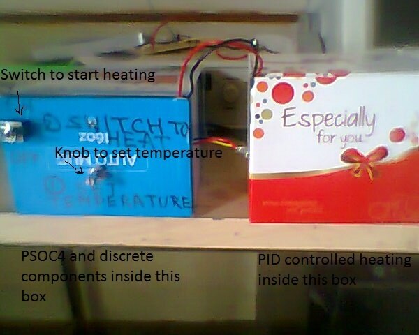

  • How does it look?
Two card-board boxes were used. With this drilling could be avoided. Please ignore the write-ups (except the texts in black) on the boxes. In yellow room such boxes are not allowed due to the high dust count. A metallic oven as shown in the picture below is required. But basic algorithm implementation remains the same.
