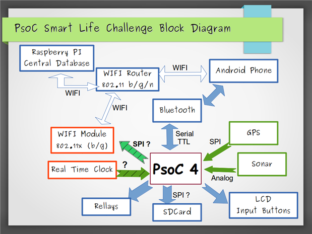

While preparing for the arrival of the chip, I did an informal block diagram of what the system should be and the interconnections (bellow).
I have no experience using directly SPI communications but like can be seen on this picture, I plan to use it a lot. Exploring the "system on a chip" capabilities of the PSoC should make it very attractive for a lot of solutions and cannot wait to start trying it.

(The arrow on the LCD should be both sides because of the buttons)

    Try setting it up using a direct connection first.
    Once you verify the protocol and synchronization issues you only have the RF issues to worry about.
