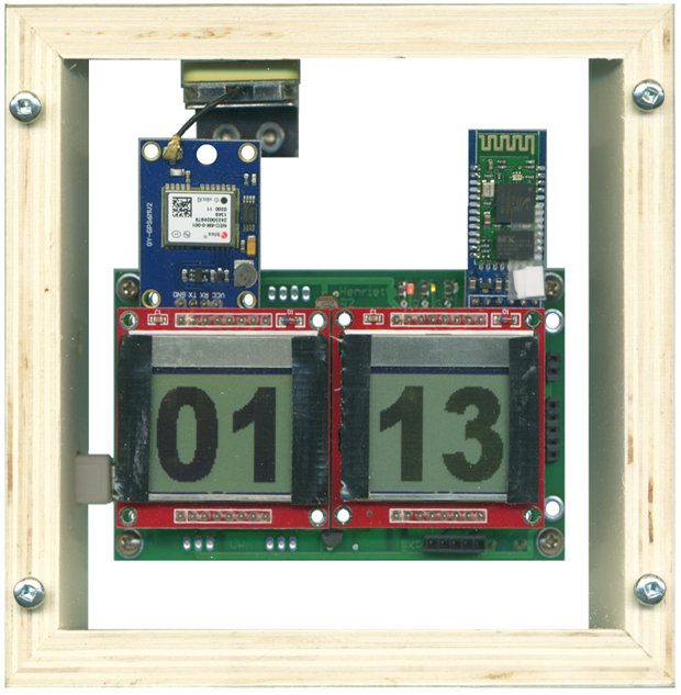

Cypress Semiconductor expressed interest in converting the Smarter Life Challenge projects to use the new PSoC4 Prototyping Kit to showcase the rich capabilities of this much lower cost module. The Henrietta Project was designed to look good with the PSoC4 Pioneer Kit at its heart, but the PSoC4 Prototyping Kit would look disproportionate in the same picture frame. So, I decided to shrink the system while maintaining the same functionality and being fully backward compatible with the firmware. I also wanted to switch from wire-wrap connections to a printed circuit board.
This led to a new design called Henrietta's Daughter because it is an offspring of the Henrietta Project.

The Build
The PCB cost $2 each to fabricate (because I bought 10 of them in a batch). I had to buy a few new parts, but had quite a few spares left over from the Henrietta Project. In particular I bought a slightly different GPS, but the original firmware still worked perfectly. The build went very smoothly, everything worked properly on the first try with no errors on the PCB. This paves the way to use the remaining 9 PCBs in new projects.

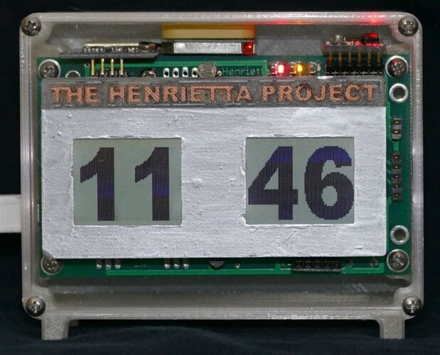

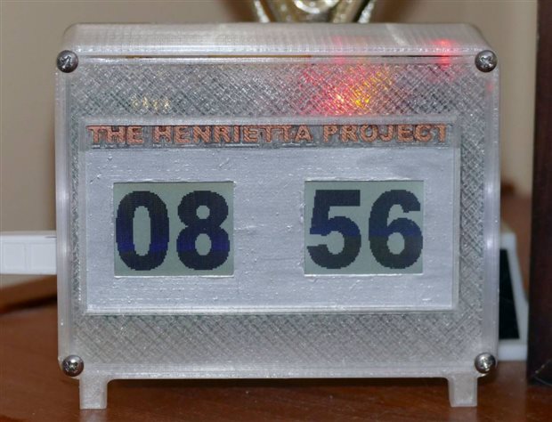

Here is a new version packaged in a 3D printed plastic case:
Click image to view video
Here is an update with PLA faceplate instead of acrylic:
