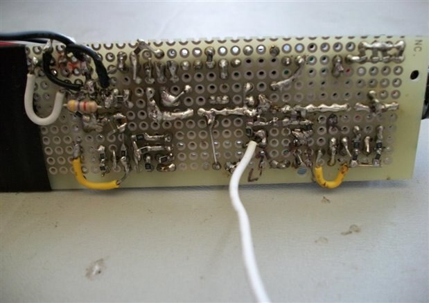

Well, now since the infrared code learner works and the brainwaves appliance controller works the only thing I need to do is to put them together.  This should be easy; however, my problem is that the code learner is implemented on the Cypress CY8CKIT-001 evaluation kit while the brainwaves appliance controller is on the Schmartboard.  So my first attempt was to bring the code learned to the brainwaves appliance controller on the Schmartboard.  To do this I had to add the 7-segment LED module, the two infrared sensors, and three buttons.  I started by looking at the schematic to see if I have fifteen available ports, and I was able to find them.  Next I looked at the Schmartboard system.  The system is implemented on two boards connected together, one is the Schmartboard with the Cypress PsoC5LP chip and the second is a breadboard that I built myself.  Here is a picture of my breadboard:
This board is pretty crowded with components and wires, and after all my efforts to find space for the additional components I just gave up.  There was no way I can fit all the code learner components on this board.  So another solution would be to add a third prototype board somehow hanging on these two boards, which I thought was somehow doable.  However, then I had a second thought: if the system works the first time it would be great, but if it doesn’t and I need to debug the circuits and replace components it will very hard if not impossible.  So I decided it is not a good idea to add the code learner to the Schmartboard, and instead I would build a custom printed circuit board (PCB) for the combined brainwaves appliance controller with the infrared remote code learner.

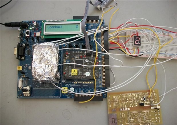

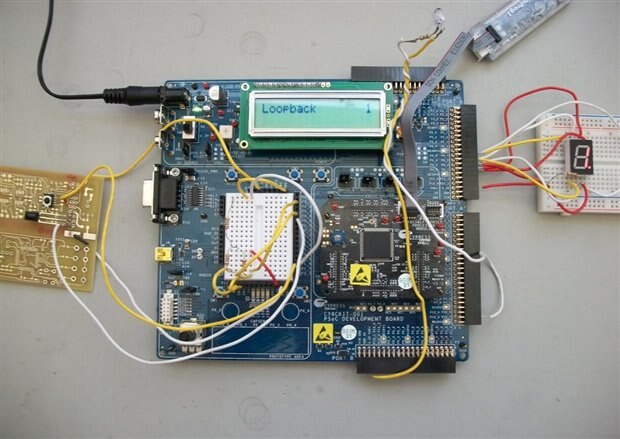

But before jumping into the design of this PCB I took an intermediate step and I implemented the brainwaves appliance controller together with the infrared code learner on the Cypress CY8CKIT-001 evaluation kit.  Here is a picture of the combined system.
I actually knew from the beginning that this implementation of the brainwaves appliance controller will not function well in this setup because of the long wire routings from the PSoC5LP module through connectors and all the way to the sides of the solder-less prototype board in the middle.  These routings capture too much noise from the switching signals and from the environment through electromagnetic interference.  To reduce the coupled noise I have built a shield around the analog circuits on the breadboard, as it can be seen in the picture above, but this was only part of the problem and the remaining coupled noise was still enough to cover the active signals.  The reason I built the brainwaves appliance controller on the CY8CKIT-001 evaluation kit was not to see it working (I knew it can work from the Schmartboard).  I actually wanted to make sure that I am able to configure all the inputs and output ports of the PSoC5LP chip the way I wanted.  I also wanted to make sure that the code fits in the memory, and to make sure there is no conflict between the resources used by the code learner and by the brainwaves appliance controller.   Even though it does not work with the signals from electrodes, this system should work with emulated signals that reassemble the electrodes functionality at larger signal amplitudes that are not so sensitive to noise.
So now I am verifying the functionality of the brainwaves appliance controller with the infrared remote code learner and I am trying to optimize internal resources and pin allocation to further simplify the custom PCB that I will design.
