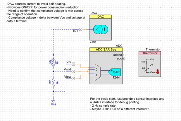

This is my first blog post. The focus of my project will be using the PSoC 4's analog integration and low power modes to create a sleep sensor. The sleep sensor will use the observed tendency of humans peripheral body temperature drop (http://www.stanford.edu/~dement/temp.html) during sleep.
For this project, it is going to be critical to get very low power so that I can have a small battery to reduce the annoyance of having the solution attached to me. In a commercial solution, any sense of annoyance would spell the death of the product. This means that I will be experimenting with the sleep modes, FRAM storage, and potentially Bluetooth Low Energy.
The screenshot above should give you an idea of where I am at right now. My plan is to go as follows:
1) Get the analog front end and temperature measurement circuit working properly. I am aiming for 0.01 degrees C resolution. I am considering a 2 Hz (or potentially 1 Hz) sampling rate.
2) Embed a low power FRAM module to datalog
3) Take data on sleep patterns, and see what we get!
4) Start to expand the project and build it into a full solution.
If you have any thoughts or suggestions, feel free to share!

    Nice to see a "analog minded" design. Have you done some calculations on the needed accuracy of both DAC and ADC?

    e14 Contributor over 12 years ago in reply to vsluiter
    The purpose of the DAC is primarily to provide excitation current at a level which does not cause the thermistor to self-heat. This allows more freedom in selecting the resistor values, as I don't need to use them to throttle the current to an acceptable value.
    The ADC on the other hand is a more difficult beast. I will need to see what resistances I will be getting from the thermistor before I can determine what I can realistically expect. I'll keep you posted.
