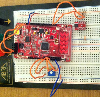

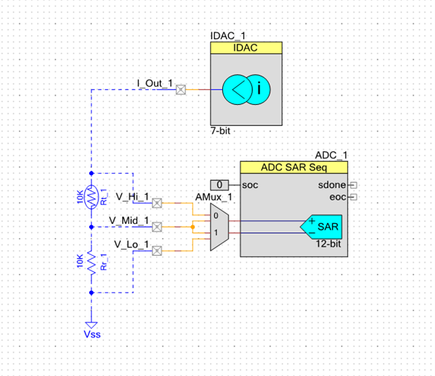

Hello All,
I've been taking a crack at the system. Here's where I am at so far:
I've gotten the ADC and analog chain to work in its most basic form. I substituted a potentiometer for the thermistor for the time being. The next step is to get the low-power FRAM memory operational and reading. When I get my parts, I'll integrate the thermistor and start testing the system in earnest.
