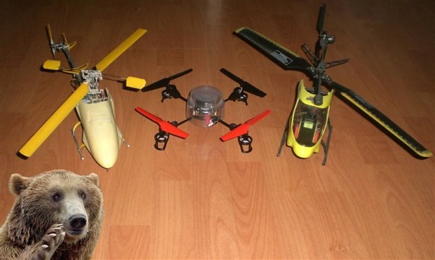

Good day comrades! I am very glad for the opportunity to participate in a Smarter Life Challenge!
The last few years, I am fond of RC models. I already have a wheeled robot, several helicopters and completely DIY micro-quadrocopter. It is time for tricopter!
