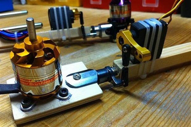

2. While the parcel from HobbyKing was on the way, I was working with YAW - mechanics:
As you know, I originally just wanted to copy this unit from David's copter:
reference to the original source: link
But I quickly changed my mind in the direction of another mechanism:
But since I never got the necessary details,  I accidentally discovered on YouTube another easily realizable design:
reference to the original source: link (see 6:29).
Finally I made a simple swivel. Assembled it all looked like this:
The main disadvantage of this design - increased backlash, because there are no bearings in the mechanism. I will try to reduce the gap to a minimum by using a precise fit of parts.

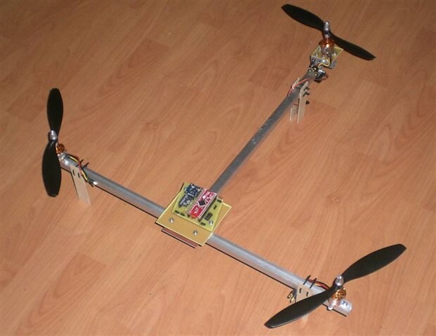

3. On Friday, I managed to find a parcel from HobbyKing. I knew that there was nobody to bring it to me and I had to go myself.
Fortunately courier service was just at 2 km from my place. Well, in the search for missing parcels I already have a lot of experience image Special thanks to Modelers club http://forum.rcdesign.ru/, for help in finding!
Bringing badly crumpled box home I found the following:
Seeing all this beauty I could not resist, dropped everything and began to build a copter! Here is what I got:
mechanism YAW:
General view of the apparatus:
Surely you're wondering how it all works! Video I shot on the phone, so sorry for the quality...
