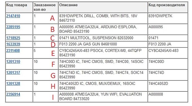

Today I want to tell you about last preparations before starting of development.
First of all I want to tell you about every part that I ordered from farnell.
A. on this photo you can find standard Russia tool set:
  1. Universal Soviet screwdriver.
  2. Damaged screwdriver.
  3. DIY drilling tool - gift from my friend (according to legend, it is made from parts of the damaged tank)
  4. Izolenta (most important part of any project)
  5. Pliers (aka universal wrench)
So I need normal screwdriver set and normal drilling tool. And I found this beautiful Makita set!
B. As I said in the previous post, the project will use the Arduino Esplora as a joystick (Tx-system) so I need it.
C,D. Tricopter is not a home project and during testing, I'm away from home. I want to have a good multitul and a gas soldering iron for this situation.
E. Microcontroller for the copters heart - Very improtant part for this project!
F,G,H. Little stuff for my DIY projects image
I. I want to use Arduino Yun as FPV video transmitter with OSD function.
And second.
