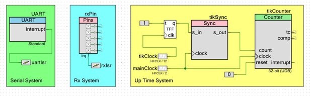

As I promised, today we talk about the communication of PSoC 4 with standard MultiWii PC Software. Today the following modules are 90% ready:
  1. UpTime system.
  2. System of communication with the receiver (this week I'll fix some bugs).
  3. UART module for configuration and telemetry.
"PSoC schematics" looks like this:

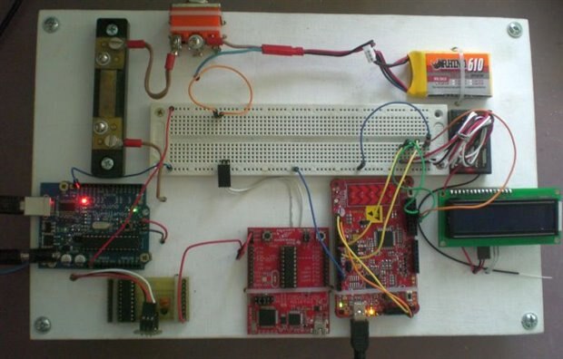

The testing station has not changed and it has the view as follows:
Expectedly, I want to talk about the UART module.
Green: UART communication module works using interrupts. I use two interrupts in a single handler (UART_INTR_TX_EMPTY and UART_INTR_RX_NOT_EMPTY).
